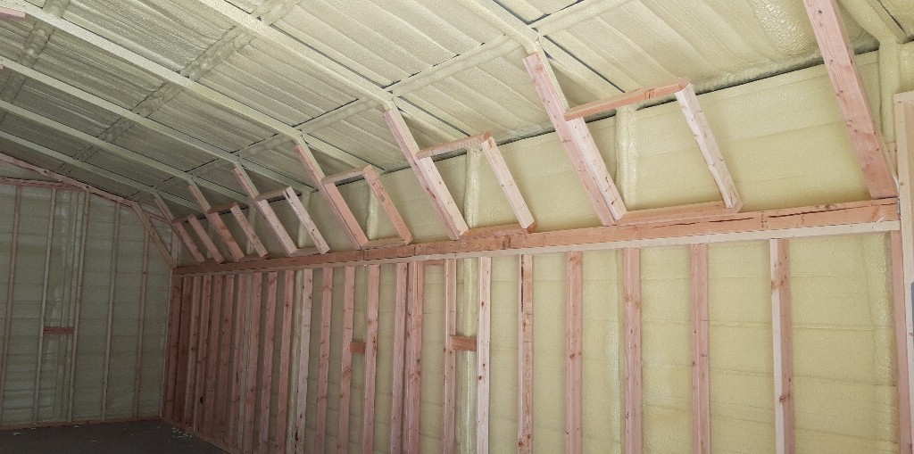

I finished framing both shops and they're getting electric installed this week! The smaller shop, 24x36, has 18 2x2 LED panels. The two batches along on the pony wall will be used when this shop converts to the paint booth. Two 2x2 exhaust fans will handle the overspray fallout. The row down the middle will be used for the everyday work.
The big shop will have three 2x4 LED panels and I'll be installing 3 windows for natural light. Two ceiling fans (two bladed Hartzell propeller looking) will be keeping air moving in that one, along with central AC and heat. This is the reassembly shop and done car shop. Well, that is, if I ever keep any DONE cars!

Nice, congrats. Make certain to use explosion proof exhaust fans.

X10...
Vaneaxial with cast ALUMINUM ROTOR -removes the motor from the air stream and Aluminum blades and ensure there is not a contact spark if the rotor hits the housing.

Yes, definitely! Very good point.
