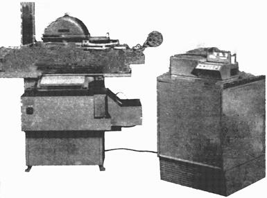

The Process is completed by the Graphitype Machine where the now punched IBM cards are fed into a tower where they are scanned and then converted in to typeset and then a tractor feeder sends one body plate at a time to be auto embossed.

The body Plate (Trim Tag) is only as accurate as the punch made on the IBM card.
