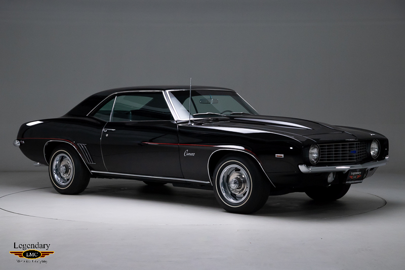

Guys, I apologize in advance. A friend of mine is looking at the car listed below. He gave me the above listed VIN. I believe the correct VIN is 124379N690437. Sorry for the confusion. Steve if you want to correct the VIN or any other changes feel free to do so.
Thanks, Doc.
https://www.legendarymotorcar.com/in...copo-2263.aspx
I think I have seen this car in photos somewhere previously... was it in Ohio at one time?
FWIW - It is really nice looking with the Red Pinstripes, no spoilers and ralleys with white lines.
Did it come with dog dishes or ralley's originally -
Done to a pretty high standard - some details kinda over restored - but really not much to complain about here. Unless photos of the stampings revealed something it looks like a nice one to me.
That's a beauty.

No tach, gas gauge should be in the center for date of build. Rally wheels should be 14x7, 15x7 only came on cars with COPO 9737. I guess Rally wheels could have been ordered, but steelies with dog dish would have been standard. Nice car.
