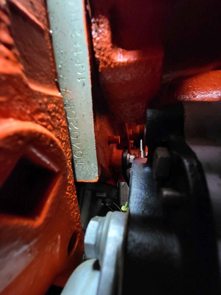

Saw that on FB too - looked like a fair price if it checks out. Had a crappy engine stamp picture, would have liked to see a clearer shot.

Someone on fb just pointed out car is second week of March built...engine is stamped for april 🤔

Restamp/Deck has been cut
----Just about to say the same thing!....Bill S
Someone decked the block and then restamped it and STILL couldn't get the date right....

this is a photo of the pad i recieved from the seller back when it still had the 632 big block in it and the original stuff was all stacked in a trailer. he claims its been checked out by several people as an "oops" at the factory i dont buy it. he owns the corvette shop in ny. bought a house this ls6 and an l34 car were in the garage with it

Factory made an error on the 4?
