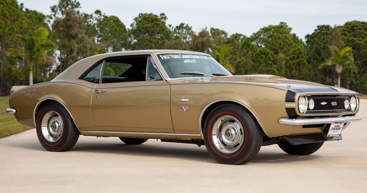

So this claim is wrong?

I was going to ask the same question Lee. ?????

It is an interesting early Camaro but have seen no evidence to support the claims of a 427 conversion.
Here is the Mecum description on it

This one claims to be the last 1967 427 Yenko Camaro

YS-760 was sold in March of 1968. It has a lot of documentation and is the last known 1967 427 Camaro

What are the early conversion parts ? Couldn’t Yenko get them from GM ?

Yenko bought headers and traction bars from Bill Thomas for the early cars.
Yenko used other suppliers as the production increased

Turbo Jet flags are about an inch too high on the gold car. FWIW.

its interesting yenko left on the small block fan shroud. i can tell by the pic if the radiator is small block also

the factory SS396 engine is located forward and to the pass side in relation to the SS350.
The BB will drop in to the SB location but the exhaust manifold hits the steering box.
The SB fan shroud will work and the SB heater core will work but the hoses are close to the BB valve cover.
getting a set of headers for the SS350 to SS427 was the key part of the conversion.
