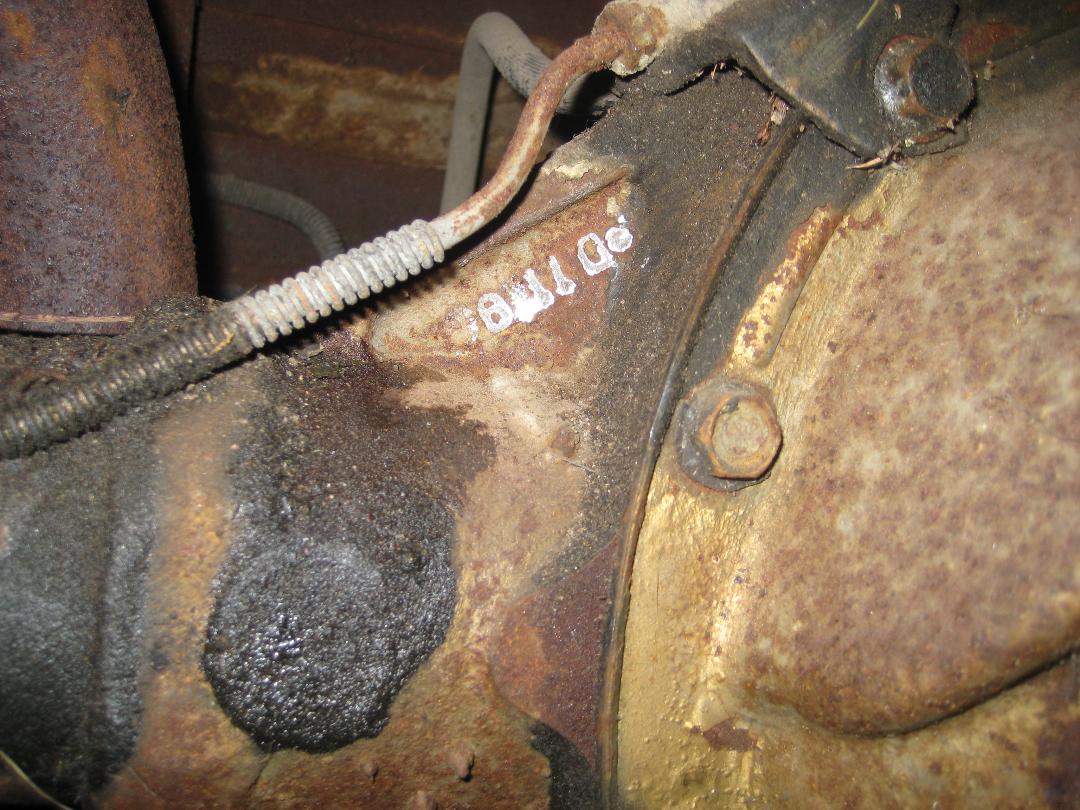

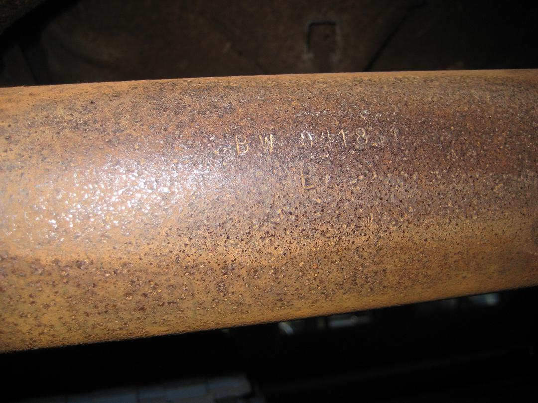

I had a 69 L78 Nova with a BW (4:56) rear in it. No paper to document, but the cast date (D 11 9)and build date (04 18) were perfectly matched to the TT and original engine cast/build date.
