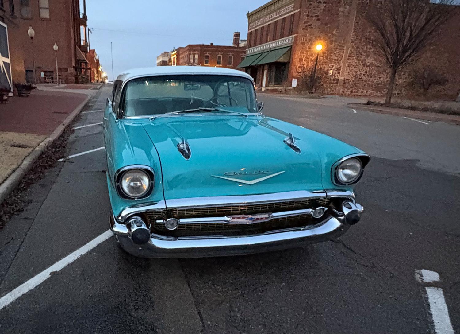

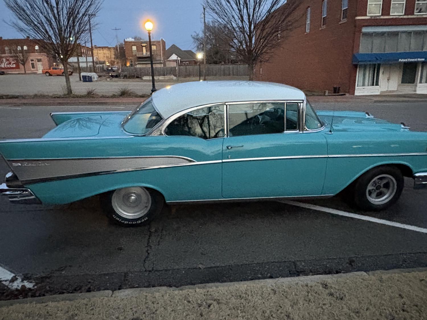

  #18
Old 01-29-2025, 01:04 AM
Lynn Lynn is offline
Location: Oklahoma
Posts: 7,725
Thanks: 87
Day three. Got the top layer of dirt off the car. Normally, these cars look better in the pics before you purchase. This one looks better in person after a hand wash and chamois.
These were taken on my phone at dusk. Not great quality. I can almost guarantee one or more will be at 90 degrees, even though I flipped them on my computer. Smart phone with a dumb operator.
