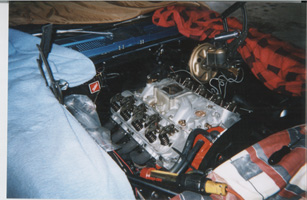

Default Re: 68 BM Phase III L-88 Progress Update
Putting some marks on the balancer to finish up the valve adjustment...... [img]/ubbthreads/images/graemlins/no.gif[/img]

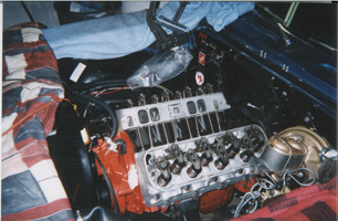

Valve adjustment complete... [img]/ubbthreads/images/graemlins/no.gif[/img]
After much sweat and 60K off of the front and rear bottoms of the intake it lines up- kinda..... [img]/ubbthreads/images/graemlins/naughty.gif[/img]

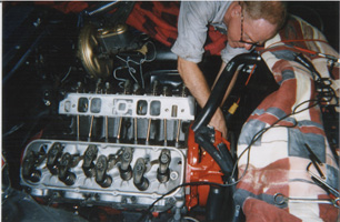

View from the other side. Job is literally a hand fit due to the head work that was completed previously. [img]/ubbthreads/images/graemlins/rolleyes.gif[/img]
