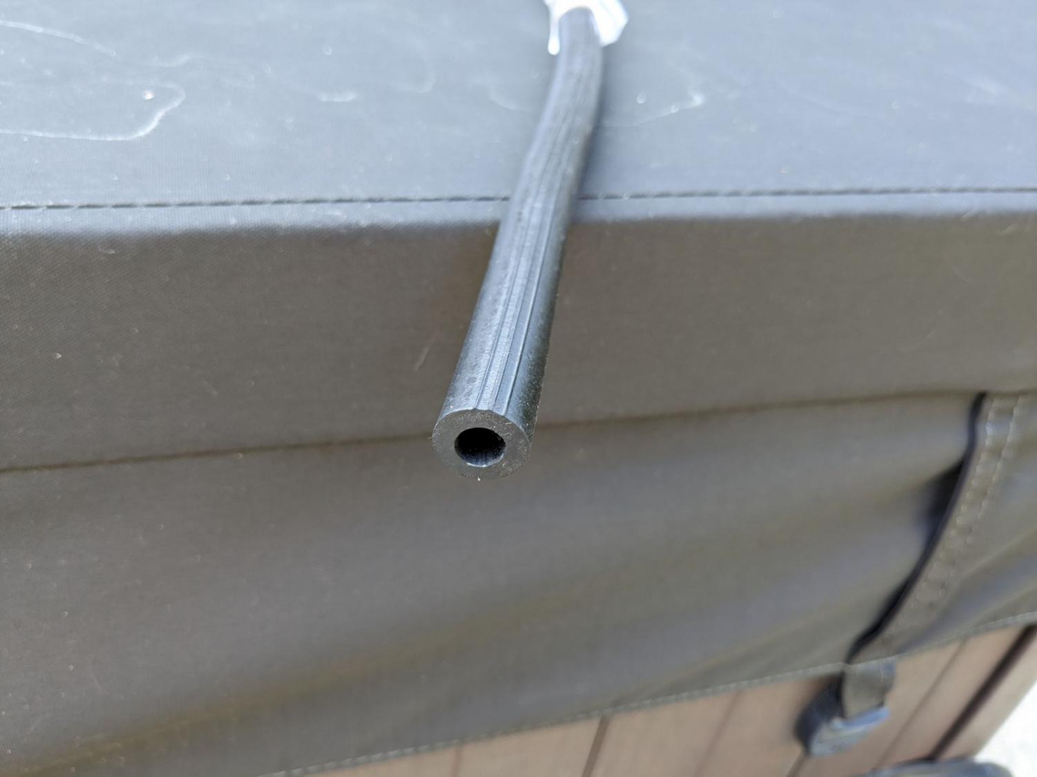

This is in reference to the ribbed PCV hose. DocRebuild
"Ours was & still is the most accurate replica down to the manufacturers identification pattern on the surface as well as the ID, OD, wall thickness & original material specification for exposure to high temperature organic gases. It's just another quality DocRebuild USA manufactured hose that matches all the OEM specifications with no tell tale noxious odor as found in uncured imported parts."
"1966-1970 Corvette 23" O.L. Formed PCV Hose with Ribs Repro Of GM 3871298 or 3868834 or 3901839"
I don't know what the part number for what the 302's hose is to make a comparison.
Gary

Went ahead and ordered the ribbed 23" PCV hose part #1745800 from DocRebuild today. I can provide pics if anyone needs to look at this item when it's delivered.
Thanks for everyone's help.

I bought the PCV hose offered by Doc Rebuild and it came in today. This is their part number 1745800 and after laying it out next to the one I have installed it's appears to be the correct length. It seems I had to do a song and dance for this guy to actually buy it. After reading what I found on-line I'm surprised this guy is still in business. If you need any other views just let me know.
Gary
