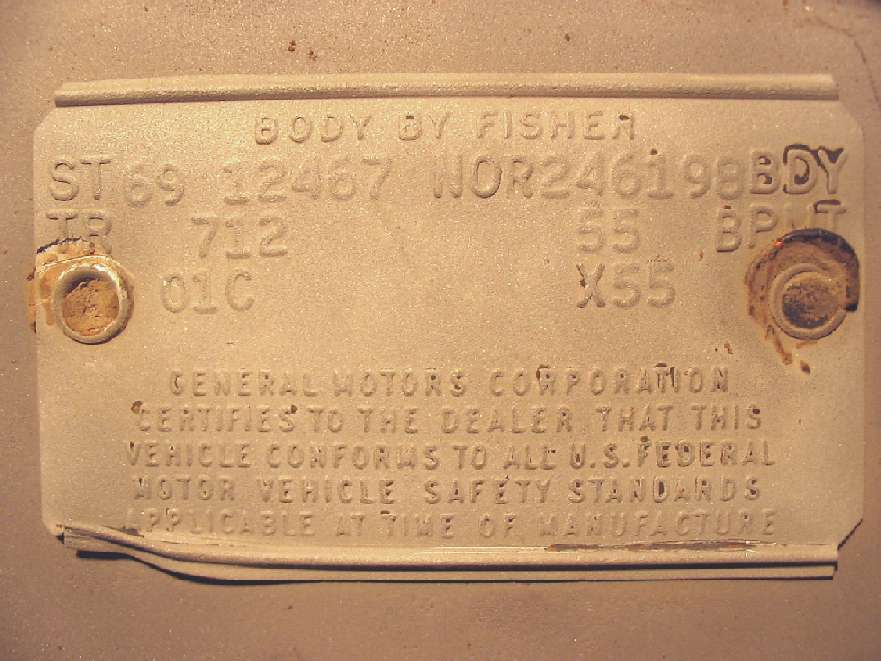

Thanks for the comments, input. I have taken pics of the cowl tag and the vin tag but the images are too large and so not allowed to attach to my post. I have the heater box and heater core clips in on of many boxes and as yet have not found them.

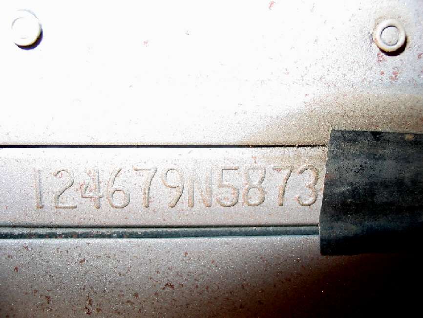

Here's the pics.
Original tags for sure.
Does it have the original axle? Do you have the axle code?
Kurt S - CRG
Old 02-08-2008, 08:23 PM
Kurt S Kurt S is offline
Location: Ann Arbor, MI
Posts: 3,074
Thanked 761 Times in 356 Posts
Default Re: Cowl tag X55 or X66
VIN

Finally realized that you are in Canada. Did you check with GM of Canada? If it was shipped new to Canada, they would have a record of the options for the car.
http://www.camaros.org/geninfo.shtml#MyCarHistory
Also, as someone suggested above, check for an X code on the rear bulkhead (trunk divider) behind the back seat.
