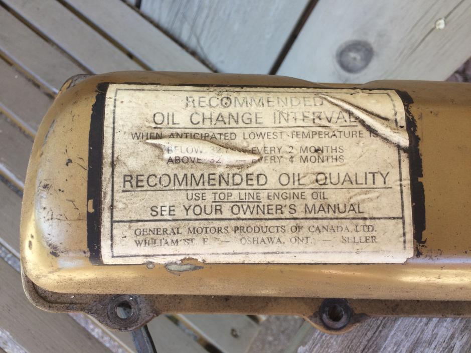

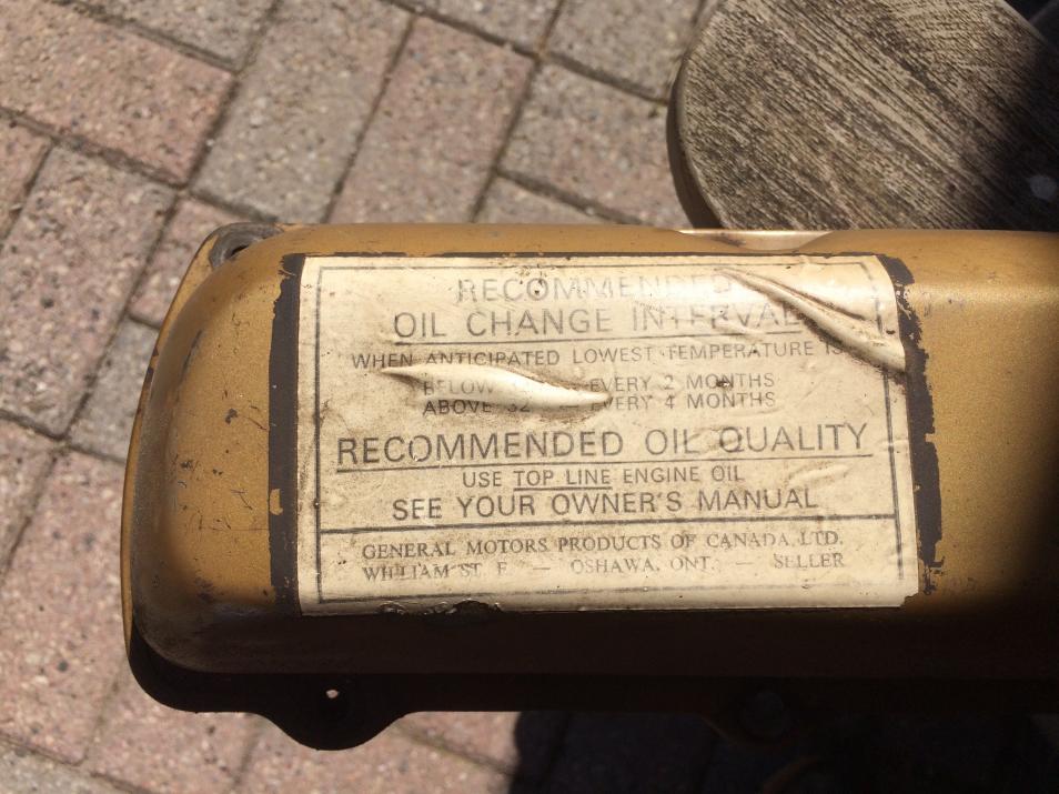

I did snap a few pictures of my Valve cover sticker:-) Can you feel the tension in the air? :-)

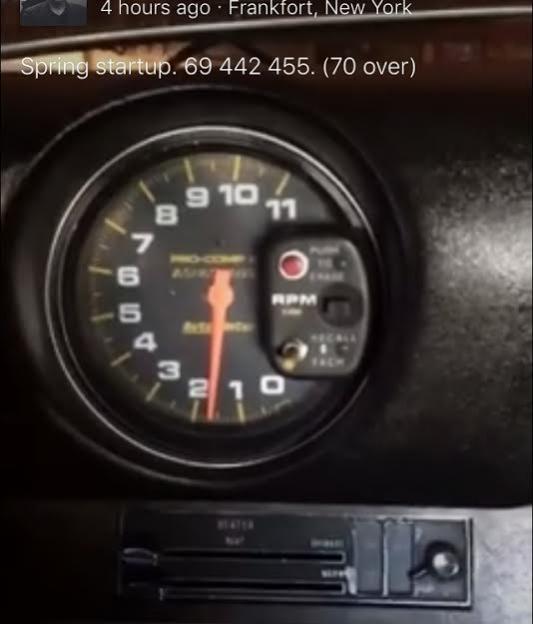

I have a tach drive distributer for an Oldsmobile
And a moroso jones tach....

I agree with Dan. Put a Sun Tach or a Sun Super Tach (but absolutely NOT a Sun Super Tach ll) on the steering column and forget about it and move on. Then you'll thank ME and DAN years down the road. Sell that one at a swap meet and get yourself a nice Sun.

Send a picture of one:-)
I am pretty sentimental about my monster tach:-) My wife used to show me her "high score", it has a memory button:-)

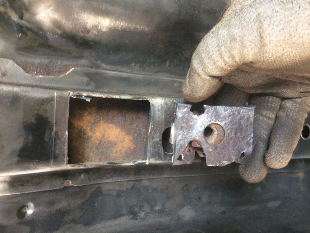

I spent a solid 5 hours Saturday and 5 hours again today on the car:-)
I am going after rust spots :-(
Here is one of the body mounts that rusted out, I will media blast it and move the cage and nut over to a fresh piece of metal and weld it in.
Ryan

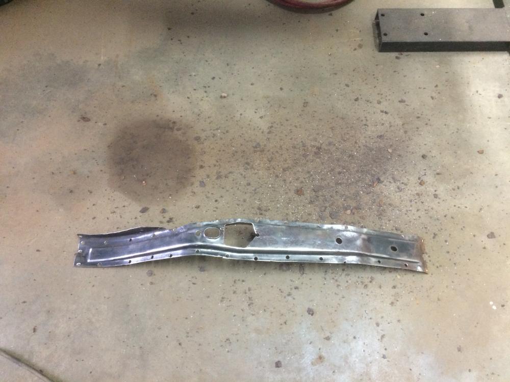

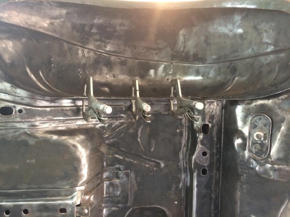

I have been working away at the drivers side rear wheel well, there is rust where the trunk floor, inner wheel well, and trunk support all meet up. I have wire wheeled and ground and picked and hammered away but the rust is deeper than I can get to from the outside....... I want to be able to sleep at night after completeing this chassis restoration...... so I drilled out the spot welds and removed the trunk support. This will allow me to media blast the inside of the support and weld up the body mount and a few week spots in the support. I will spray the back side with weld through primer and it will be good for a hundred years:-)
This will also allow me access to repair the trunk floor right at the edge where it meets the wheel well, I will add a pice of sheet metal and weld it all at the same time where the spot welds were:-)
I will also grind the backside of the wheel well in this area so no rust is left:-)
I am pretty sure this means I will be restoring some of the inside of the trunk, which I was going to do later anyways.
Pity no one will see this:-)
