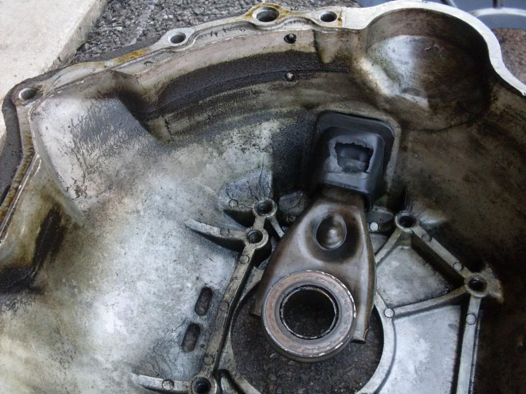

<div class="ubbcode-block"><div class="ubbcode-header">Originally Posted By: njsteve</div><div class="ubbcode-body">Got the engine out today.
</div></div>
BTW, Here is today's challenge:
Does anyone know what else is wrong in this photo??? [img]<<GRAEMLIN_URL>>/rolleyes.gif[/img]

<div class="ubbcode-block"><div class="ubbcode-header">Originally Posted By: njsteve</div><div class="ubbcode-body">[quote=njsteve]
Does anyone know what else is wrong in this photo??? [img]<<GRAEMLIN_URL>>/rolleyes.gif[/img] </div></div>
Clutch fork rubber boot installed inside rather than outside ??

Very good!
