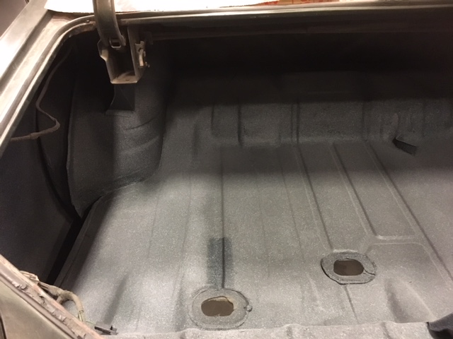

Splatter paint they used matches the original quite well, not as beautiful as the 999 crowd that have custom process’ but wow compared to the way the trunk looked to now makes me a happy guy!!! Trunk is dusty so pictures are not great.

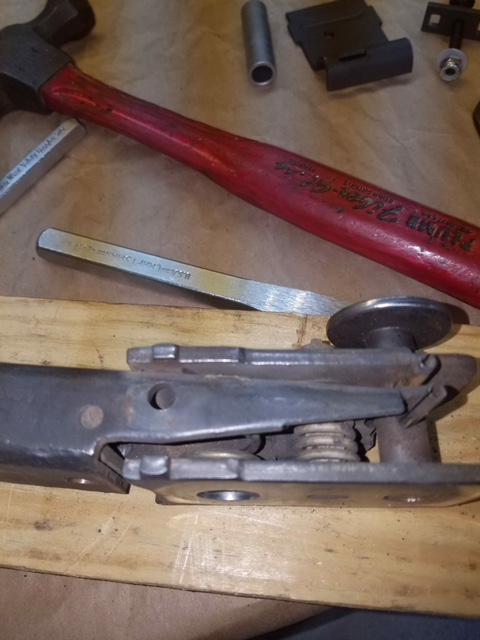

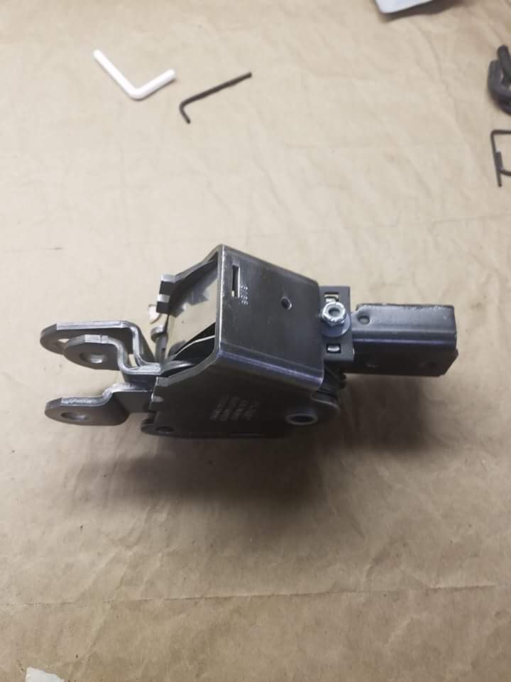

Nick Morocco built another shifter for me, as I gathered all the original style parts and want to go back to OG :-)
Ryan

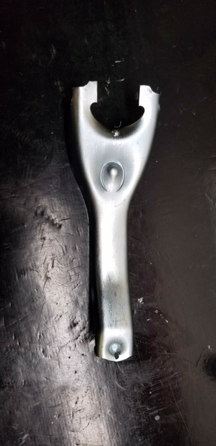

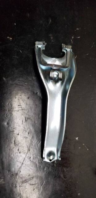

The Clutch fork I had bought is different at the one end so I have a second correct one otw.
Ryan

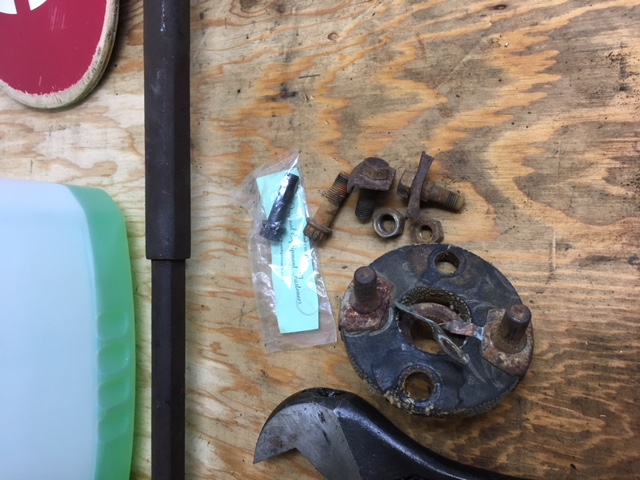

I started preparing the steering shaft.
I need ideas for the rag joint... what to do? The material is ripped so maybe I need a repop?
Ryan

Old 06-06-2018, 02:42 AM
70post 70post is offline
Join Date: Jun 2009
Location: Austin, TX USA
Posts: 112
Thanked 25 Times in 18 Posts
Get a good used rag joint OR check on repros.
Be aware that a power steering Abody rag joint is different VS a manual steering joint..different diameter splined hole.
I'm not sure if manual box rag joints are repro'd or not but know there are plenty of repros available for power steering. There will likely be some small differences in the "look" of the repro so don't expect an EXACT REPLICA.
On the rubber grease boot on the steering column end of the shaft....clean it well and see how it looks. If it's not torn or all cracked just leave it in place and it should be fine. New boots are available repro but that old rubber survives fairly well.

Inline Tube only carries PS rag joints.
However you can find a nice original MS rag joint out there.
