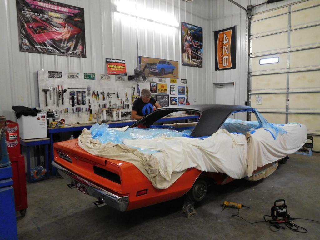

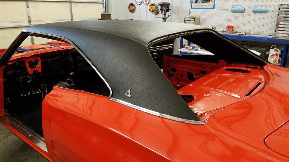

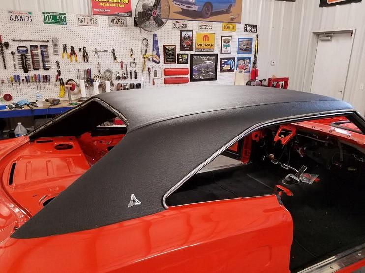

Wow, that looks great. What kind of glue did you use for the top??

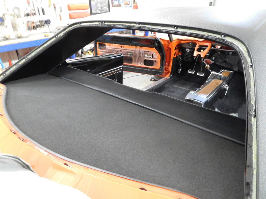

Package tray in. I was able to reuse the original rear interior molding along the headliner retainer as well as the original molding on the back of the package tray. The tray itself is actually in great shape and I could have reused that too. But there are a few scuffs on it, and that carboard is a pain to fix when scuffed.

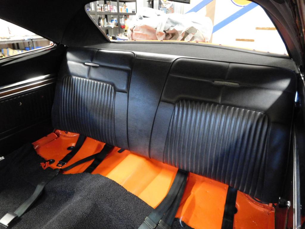

Original rear seatback installed!!![img]<<GRAEMLIN_URL>>/biggthumpup.gif[/img] Can't wait to get the lower part installed and then try it out, er, I mean...yeah, you know what I mean!!![img]<<GRAEMLIN_URL>>/naughty.gif[/img]

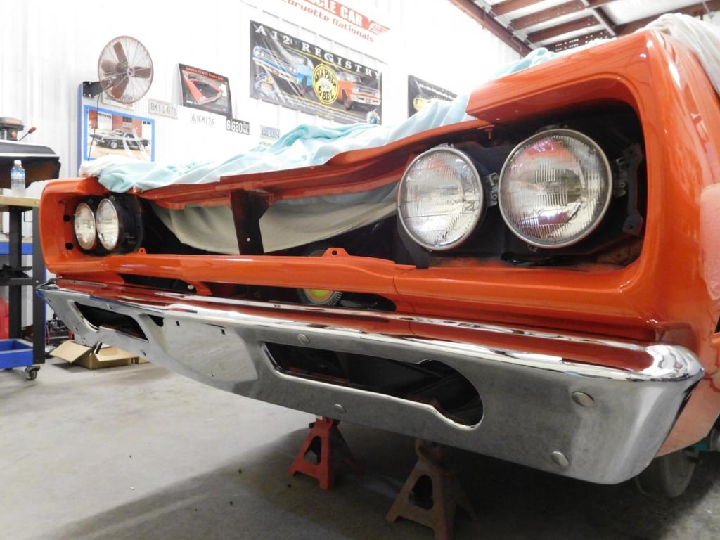

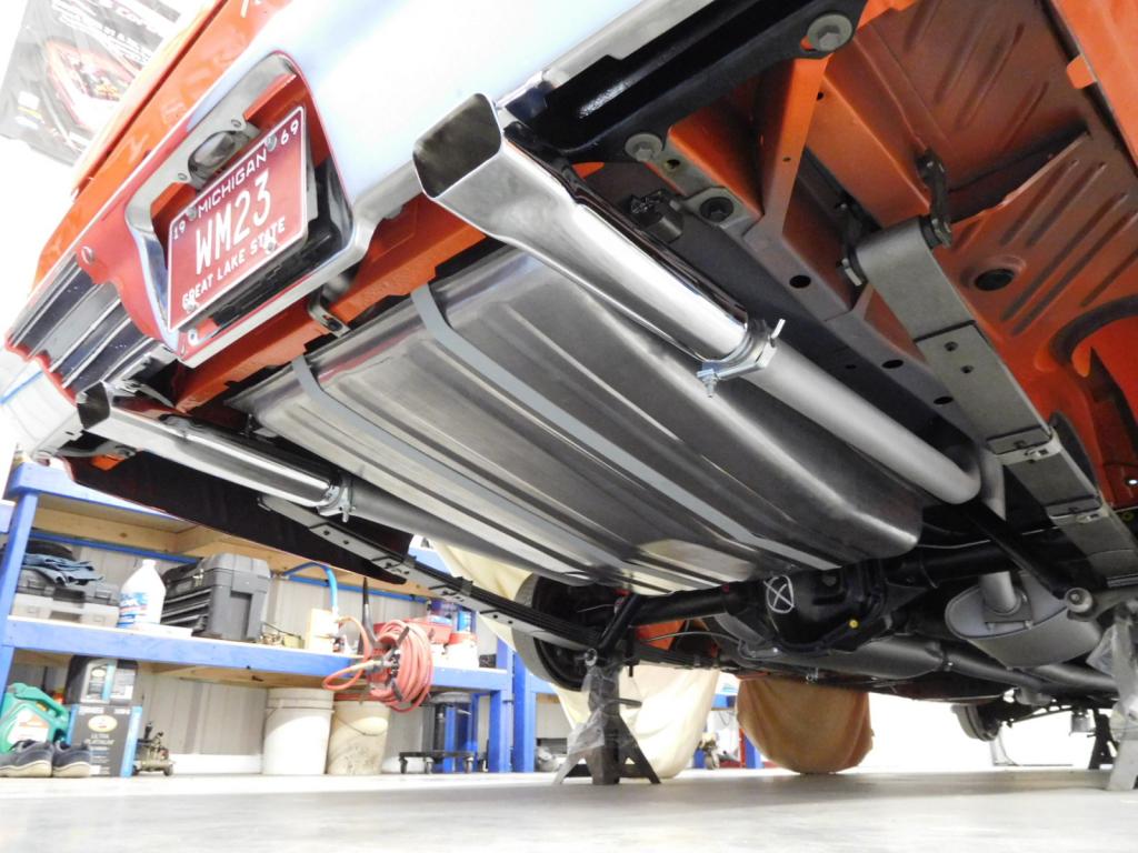

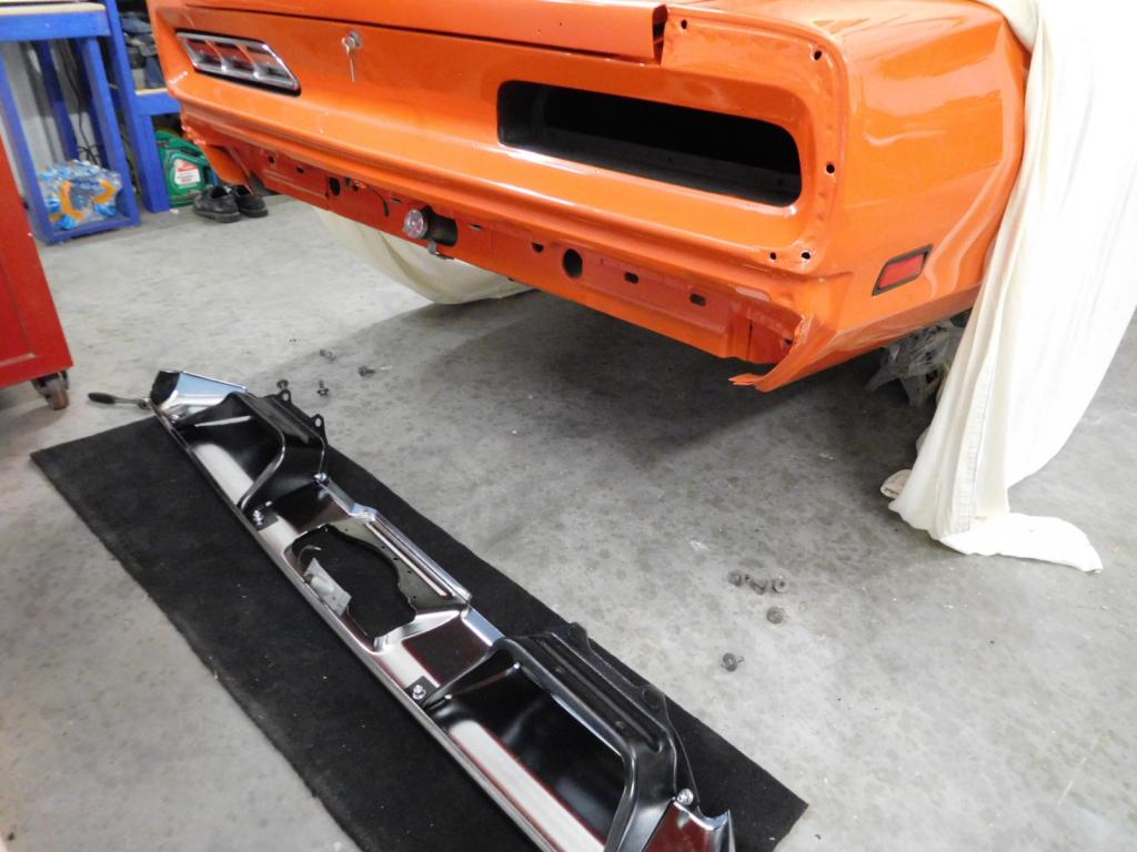

Rear bumper going on too. Also, along with that are new tips and clamps. You'll notice a missing tail light. The driver's side is an NOS unit, and the passenger side I'm restoring. As a result, I'm waiting for the bezel to come back from the chrome shop. Once I have that I can mount it up!
Not much back here left to do!

----Dave,,,Only because I have never restored a Mopar, I'm wondering if the holes for the bucket seats are always done the way you have them. I'm so used to GM stuff with flaps covering the bolt heads.......Bill S

Bill....the holes for seats on Mopars, from what I've seen on the cars I've done, is really just a little slit and the stud is shoved through the opening. I wanted to make my life easier with the seat installation and precut the holes out. The seat tracks have 1/2&quot; thick plastic spacers that go underneath and get sandwiched between the track and the floor.
Top glue was Weldwood Landau Contact cement that Mike posted earlier. Or is that Wilwood? [img]<<GRAEMLIN_URL>>/hmmm.gif[/img] I always get those two confused....no wonder I can't come to a stop!!!! [img]<<GRAEMLIN_URL>>/thumbsdown.gif[/img] Anywho, I spray the roof and let it dry real good. About 30mins. I then sprayed the underside of the top and let that dry the same. I then came back and sprayed another light coat on the roof and after a 10 minute set up (dried), I laid down the spare vinyl I had to prevent the top sticking until I wanted it to. I then folded the top over just a bit, and started to press the roof down while pulling out the old vinyl under it. All the while, stretching and pulling. It felt like an exercise video! [img]<<GRAEMLIN_URL>>/wink.gif[/img] &quot;OK Girls, now pull and stretch, heat and pull, stretch and pull. Who wants a good looking top? Stretch (puff) and pull (huff-puff)...&quot; [img]<<GRAEMLIN_URL>>/thumbsdown.gif[/img]
