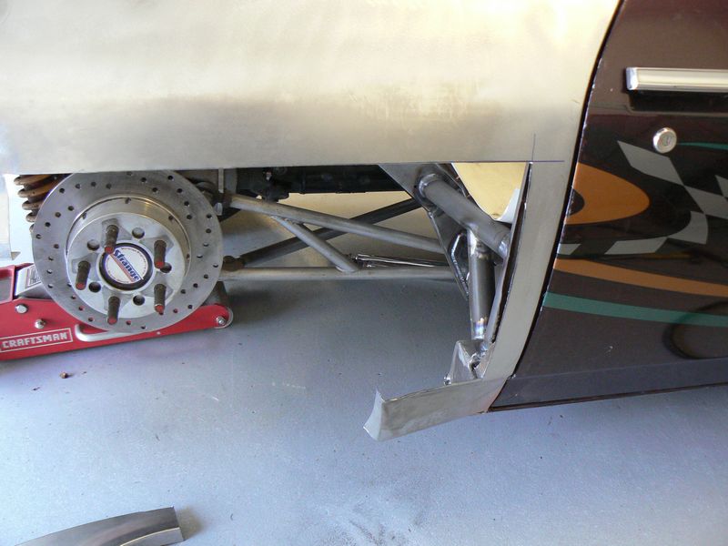

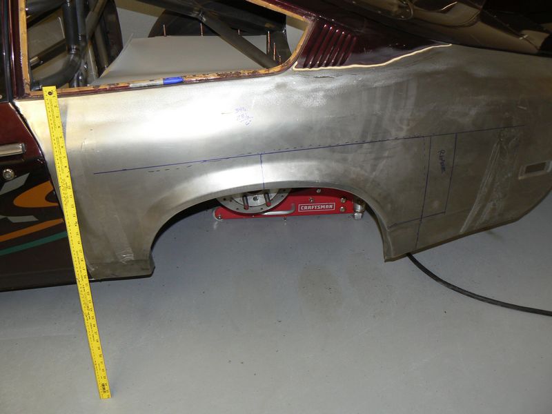

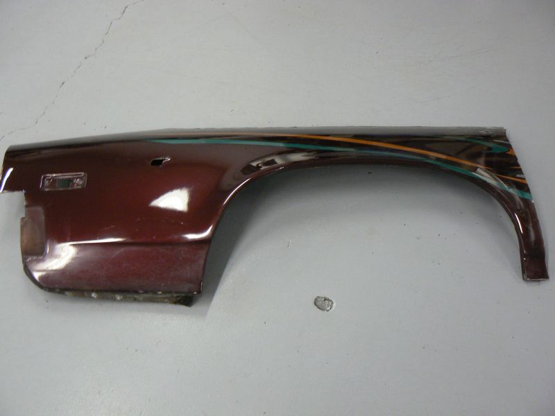

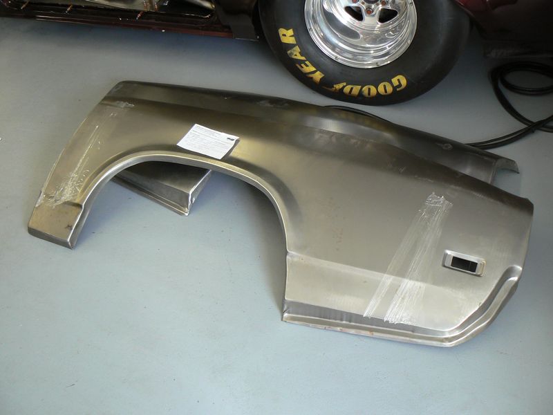

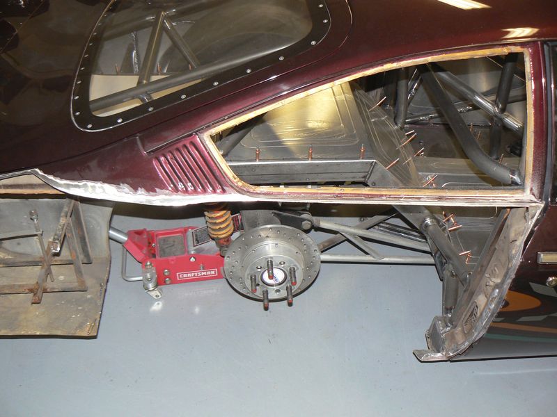

Remember those not so nice rear qtr's?
I finally found some <span style="font-weight: bold">new</span> that were suppose to be American sheetmetal. However they were located in Canada...Who knows!!! [img]<<GRAEMLIN_URL>>/hmmm.gif[/img] at this point it really didn't matter, if you've ever tried to find replacement sheet metal for a Ralph Nader Reject [img]<<GRAEMLIN_URL>>/laugh.gif[/img]
BTW the marker light holes were filled also.
Dicky [img]<<GRAEMLIN_URL>>/flag.gif[/img]

Old 10-23-2011, 02:36 PM
Dicky's Avatar
Dicky Dicky is offline
Join Date: Dec 2008
Location: KCYS
Posts: 704
Thanks: 61
Thanked 13 Times in 10 Posts
Default Re: My Supercar

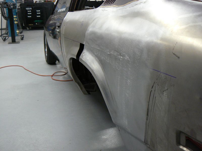

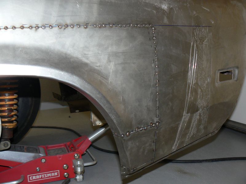

Same treatment on R/H side.
DH [img]<<GRAEMLIN_URL>>/flag.gif[/img]

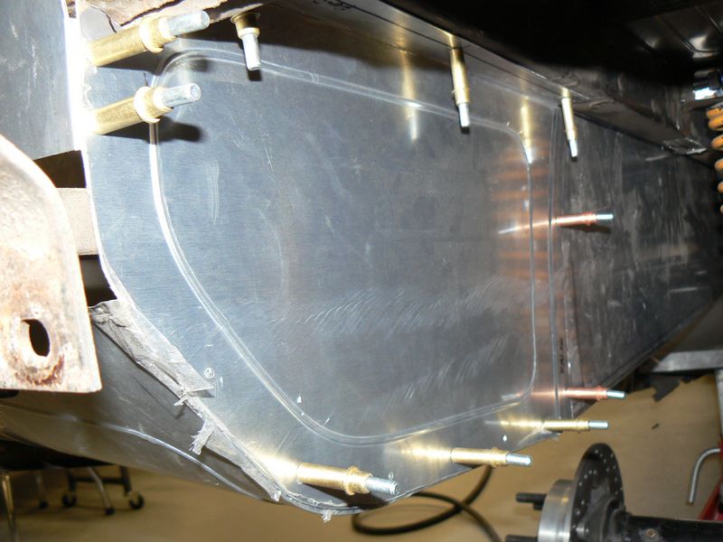

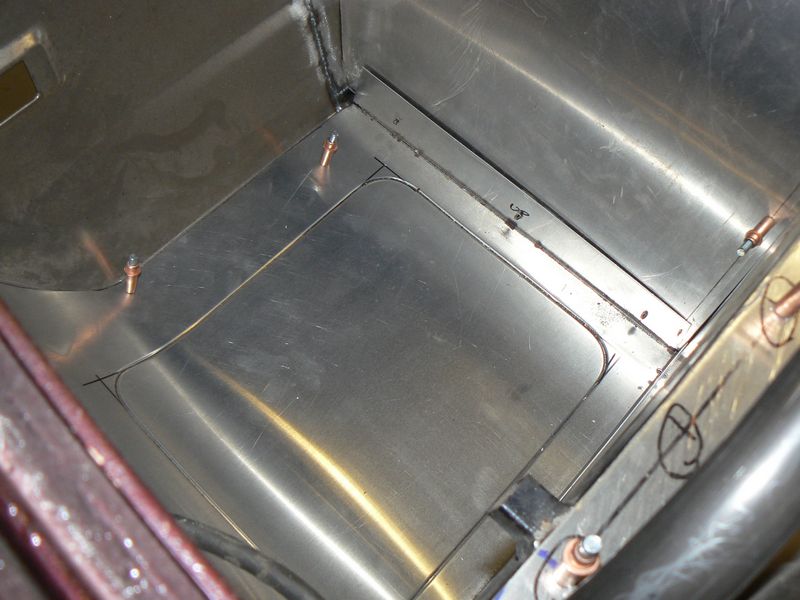

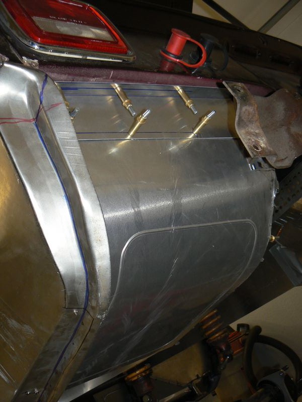

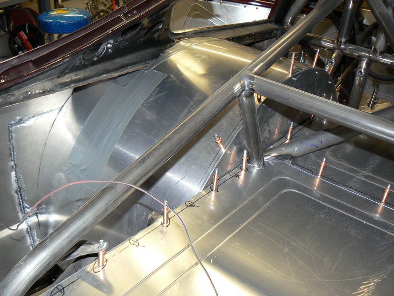

<span style="font-size: 14pt">Now it's time for new TUBS etc.</span>
They were ultimately lined with 3/16' black lexan to prevent rock damage to the aluminum. [img]<<GRAEMLIN_URL>>/cool.gif[/img]
