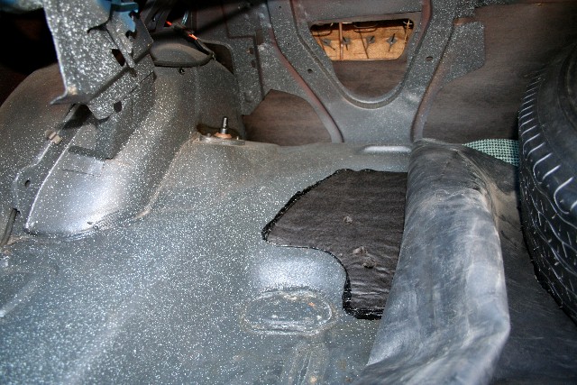

Lynn,
Here is a shot of an original Norwood built '69 Camaro trunk paint.

Does anyone reproduce that tar mat that goes over axle hump under spare tire? I believe that was part of deluxe interior package as well as trunk mat?
