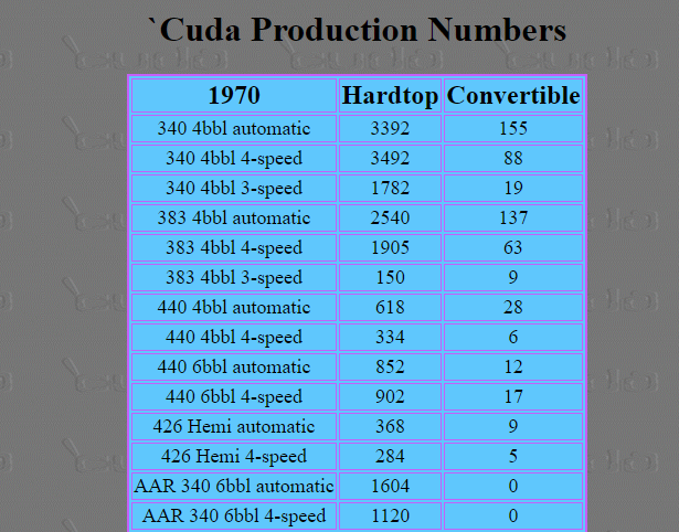

Dave . . . do not give in to the dark side and add stripes (V6X). They weren't on the car as ordered. It is a very rare car because of the N96 Shaker Hood. Without it, it's just a 340 'Cuda and Plymouth built plenty of them:
