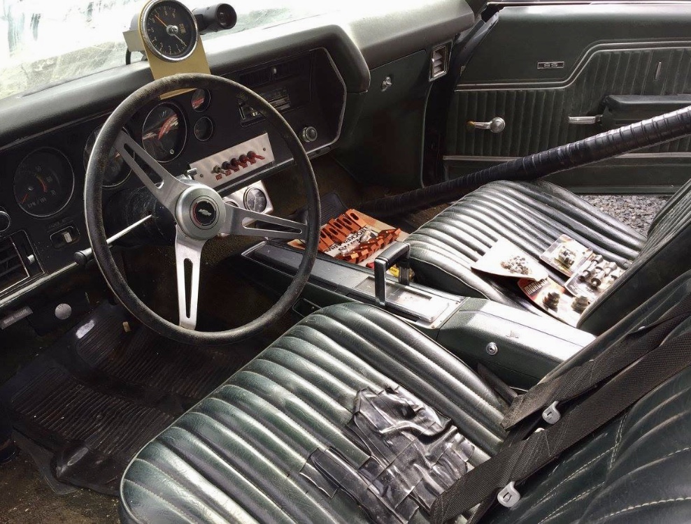

Originally Posted by XXXBlackLs6M22 View Post
Also a skilled inspector would spot the A/C Vents on the dash and block off plates under the hood knowing an LS6 never came with A/C LOL
All that was changed over. What’s posted in this thread are the “before” pics. Check the ebay listing for the “after” pics
