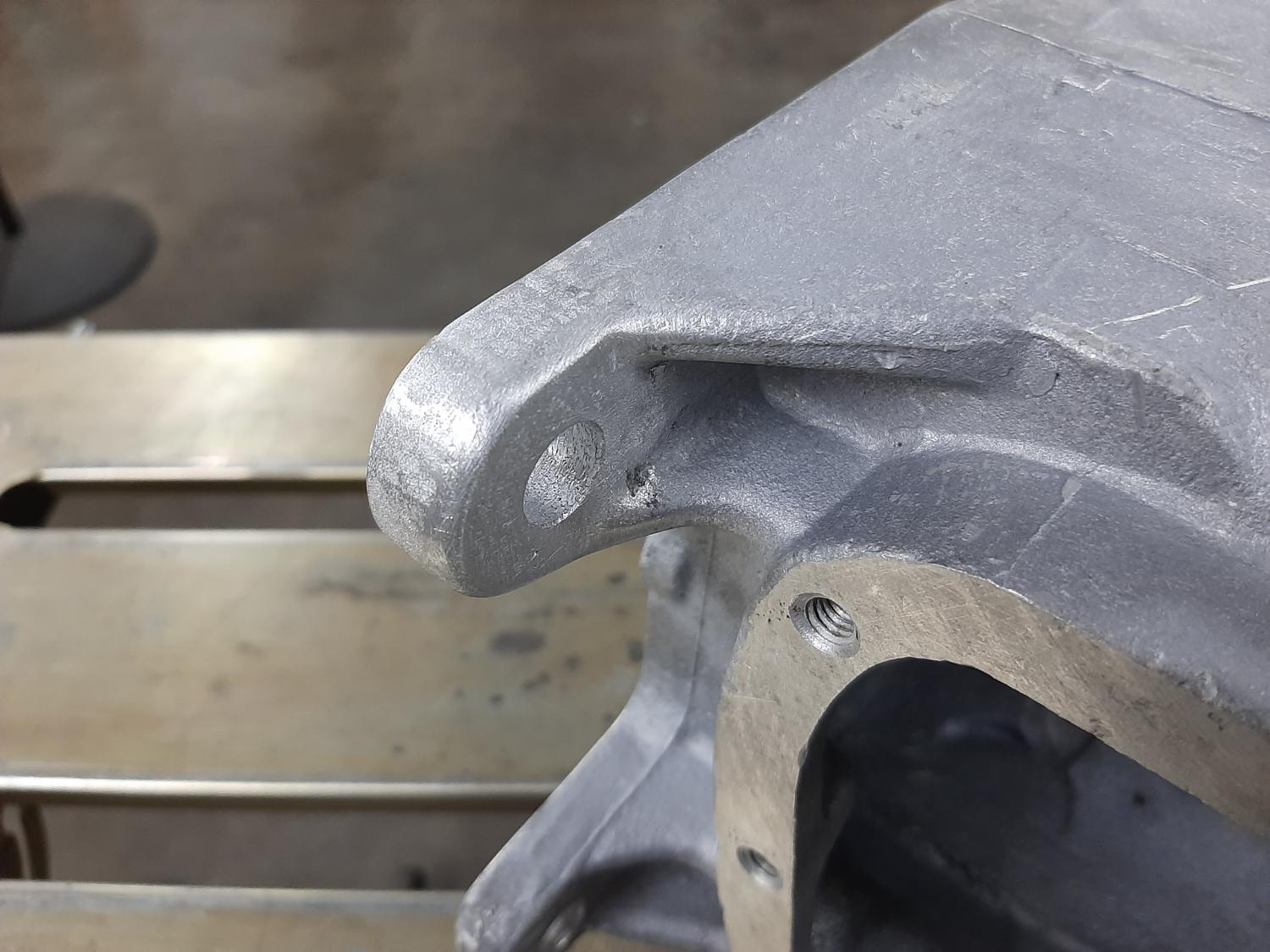

big gear head's Avatar
Join Date: Mar 2012
Location: KY
Posts: 3,381
Thanks: 5,651
This is one that I fixed.
Freddie

Many people try to weld the broken ear back on the case. This usually doesn't work out very well. I've found that the best way to repair the case is just to build up weld and make a new ear. The case above was repaired without using the broken ear.
Freddie
