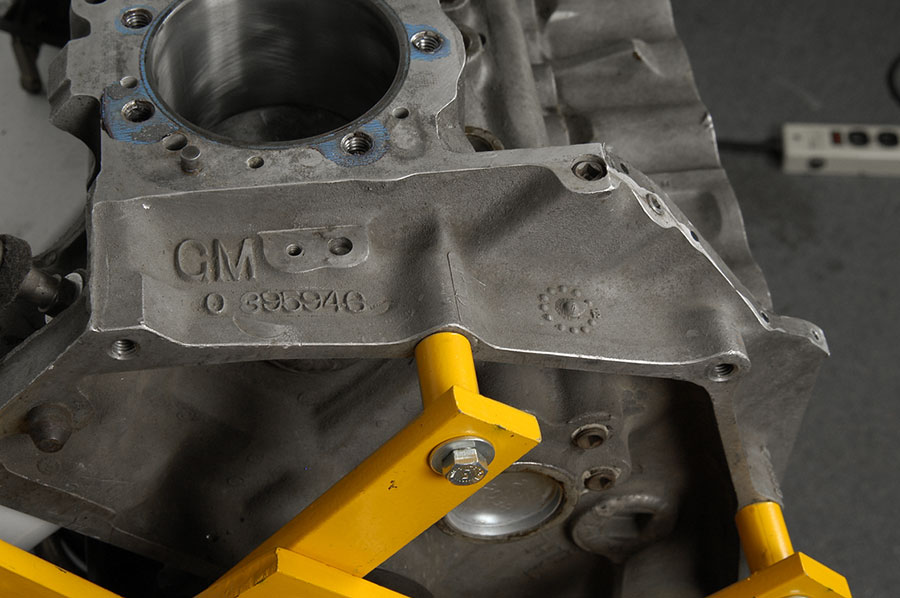

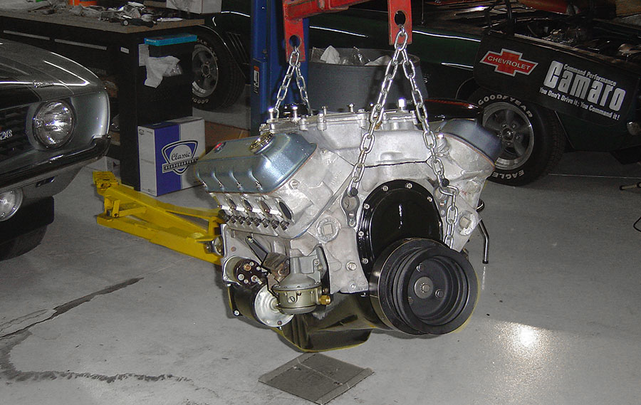

This block looks similar and has casting number 0 395946. Does anyone know if the 0- casting numbers were assigned in numerical order? I’m curious if I could narrow down the time this was made based on the casting dates of other experimental parts in relation to the number after the 0-. For example, was this block with the 0 395946 designed after mine with the number 0 359198?
https://hotrodenginetech.com/1969-z28-canted-valve-302/

0 240983 is the Grandsport engine casting number - however the description sounds the same, notched cylinder block to accommodate a 3.75" stroke, 4 bolt mains, thicker webs and pressed in Steel liners.

O-172978 is the 63? Alcoa Casting Cerv. Block in the 'Vair link.
Anything on the Bore/Stroke of your engine yet Jason?

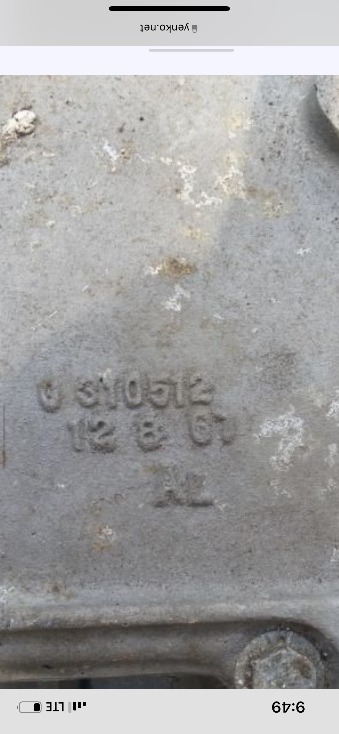

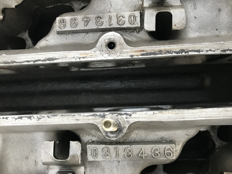

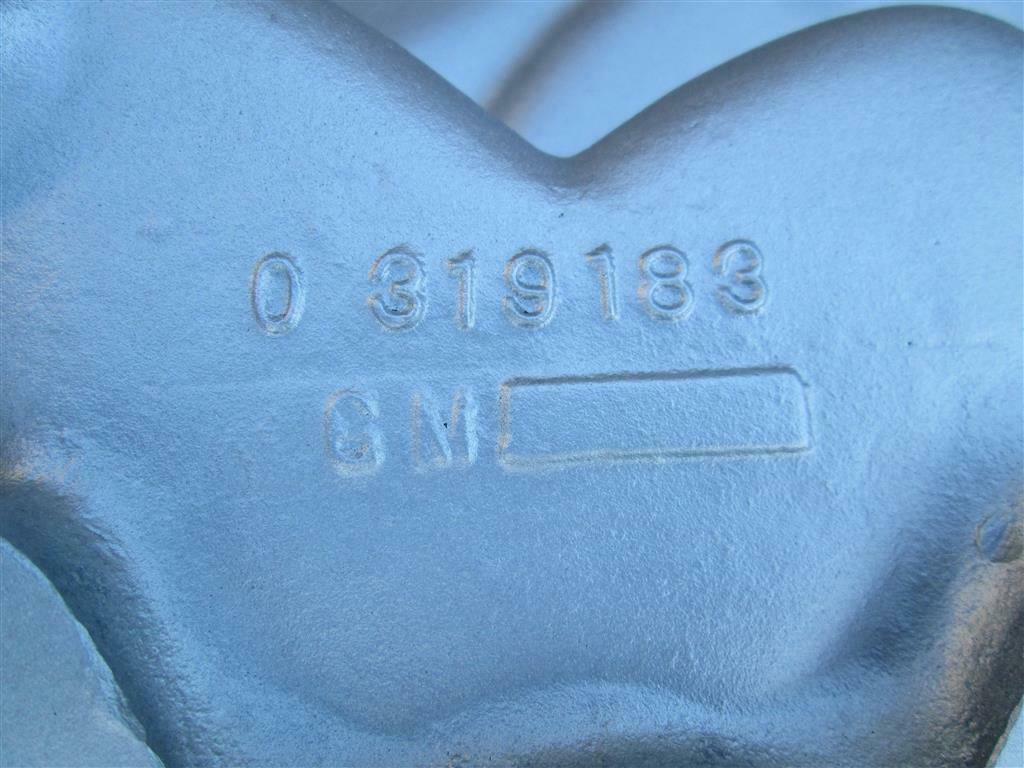

Here are some other 0- casting numbers with their associated date codes:
0313436 5/27/68 Big Block Chevy Heads
0-319183 12/5/68 Big Block Chevy tall deck intake

0-310512 12/8/67 Crossram Intake Top
