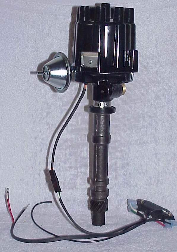

Default Tach drive (Corvette) small body HEI
This first picture is of a full HEI setup in a tach drive (Corvette)) distributor. Due to the tach drive assembly, the module is remote mounted...but, if you remove the module, then you are left with an MSD trigger conversion for those fans of the "red boxes".

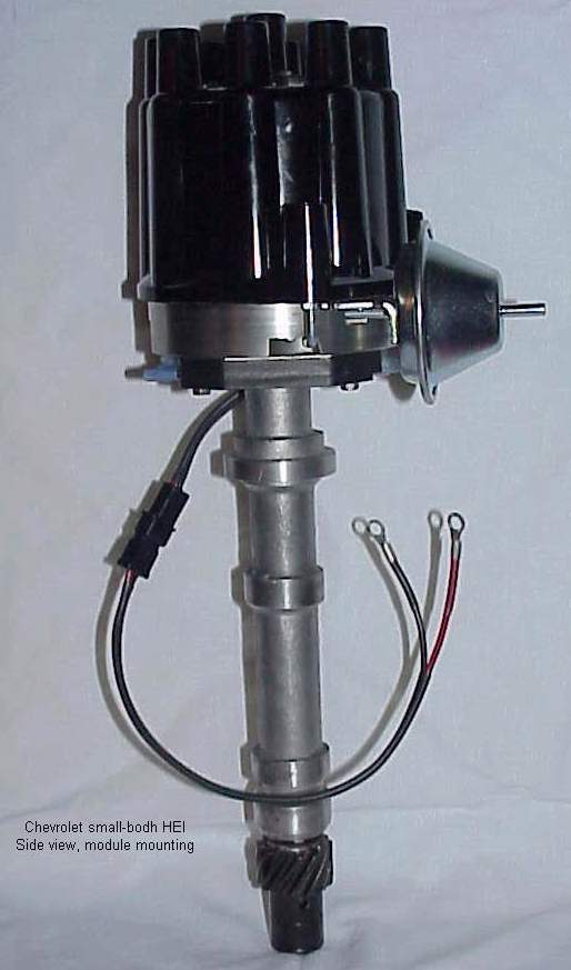

Default Small body HEI w/module
This second picture is of a small body Chevrolet distributor converted to HEI, with the module mounted on the bottom of the distributor housing.

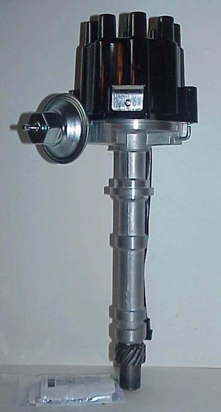

Default Small body w/MSD hookup
And here is a stock small body distributor with the MSD magnetic trigger installed (shown with optional Crane adjustable vacuum advance)...just plug it into your favorite MSD box and go.
