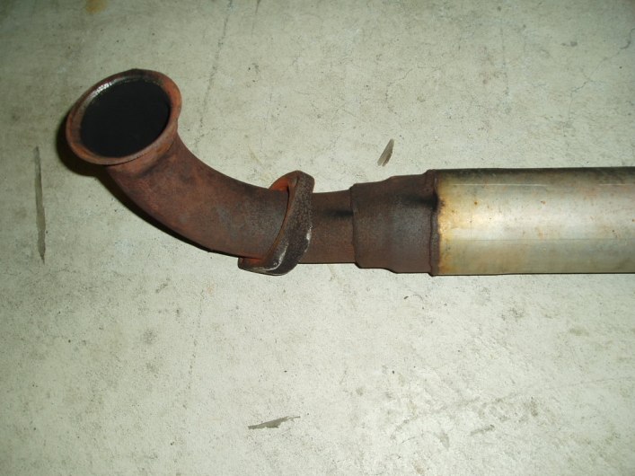

Gotta love this guy's version of a performance exhaust. The car still has its stock 455HO manifolds (non cracked) with all this stuff attached to it. See if you can count all the adapters on the exhaust system

Here's some more adapters...

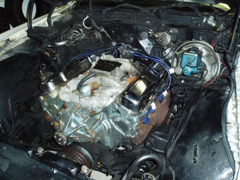

Here's the engine compartment ready for engine removal. All the toasted wiring is on the cowl.

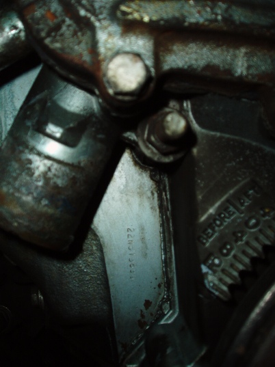

And here's the engine VIN in case anyone out there is unfamiliar with Pontiacs. It is stamped on the passenger front face of the block, below the water pump inlet. Just about impossible to see unless you're under the car, looking up, or you've removed everything in the way.

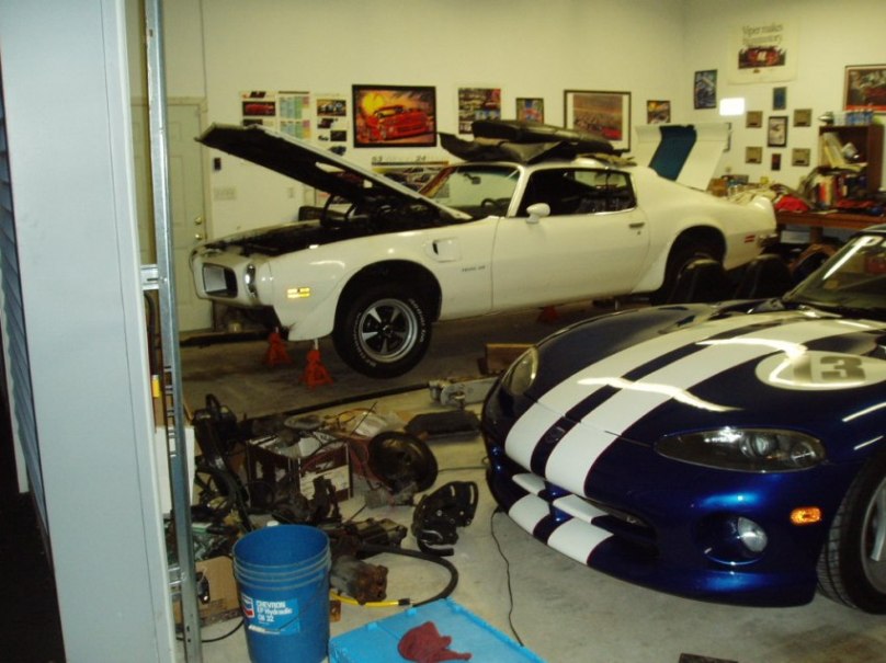

And here's the mess that is the garage...

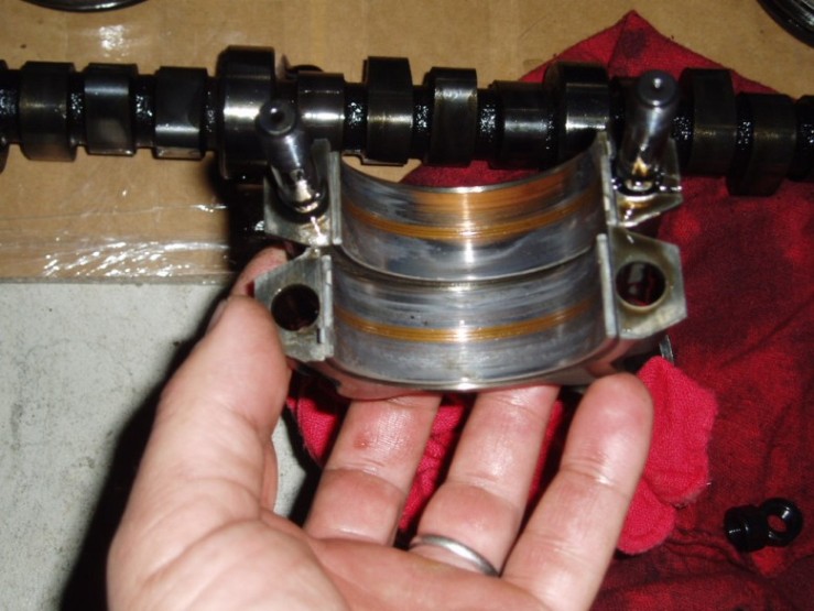

I also tore the engine down and found that the bearings are bad and the crank was previously cut 010 and 030. So it's new crank time. I might just go for an entire internal reciprocating assembly kit from Butler Racing since the original block is already 040. I have to get it measured to see if we can keep it at that size. Here's a shot of the rod bearings. Caught it just in time I think. And no, they're not supposed to be fully grooved bearings!

Here's a close-up!

Throw those rods in the trash can and get some new ones from Bulter, he has some really good stuff at great prices.
