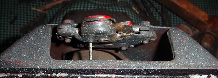

Jon, from discussions I have had with Mike and others I thought that the LOS plant did things different. The two 67 Z's I have here are the same as your car, plated strikers and latches. That early Norwood L78 I had here a while back was either a late Feb or early March car and the decklid striker and latch were painted red as were the door latches. I have one picture where you can barely see the door striker and it looks unpainted. I know the car had one repaint but the jambs were original paint. See the attached picture showing the decklid latch, I have one of the striker somewhere...............RatPack............

Here is a picture of the decklid from the same car...........RatPack.............
