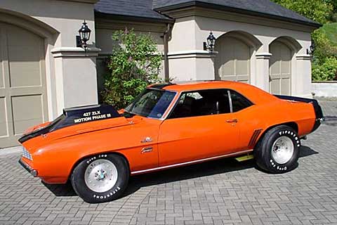

So after some research, I think I found out a few things:
Also noted in the listing is the you COULD get a 480" version for Marine???
Heads seems to be a bit confusing? Seems "originally", you would get the 026 heads, and later the 990's. BUT seems like you get order the ZLX short with 074 heads! As was seen on Kevin's '69 Z28 ZLX conversion.
As for the intake, seems the #198 intake was on the engines UNLESS you went to the FULL COMPETITION top-of-the-line Hp rated engines, THEN it looks like you got a Weiand Tunnel ram.
MUSCLECARKID, you posted an piece for your 1976 Motion Performance Guide, and it shows a ZLX427 with 650Hp. I wonder what the ZLX454 and ZLX480 made? If the 427 was 650, just using the cu/hp formula, the 454 should be about 490 and the 480 should be around 730!! Wonder if any of those made there way into a car????
LOOKS LIKE ONE WILL NOW THOUGH!

Picture taken when Kevin S. owned it.
