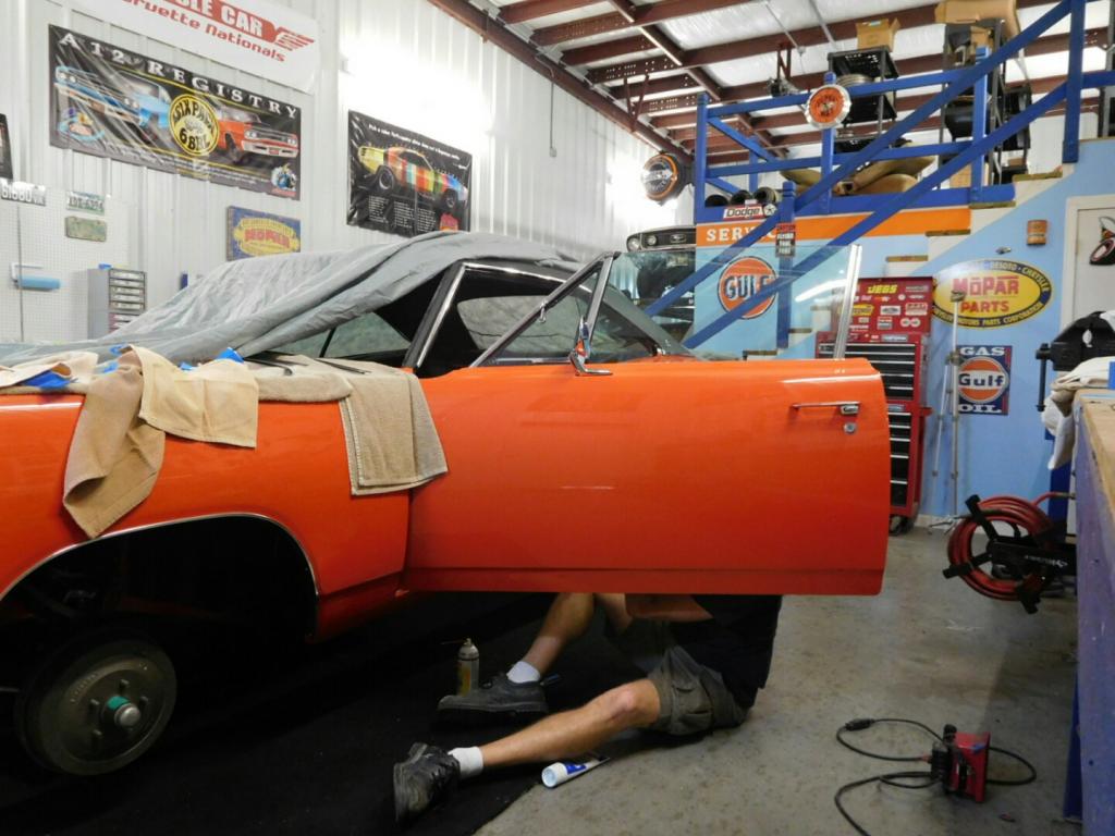

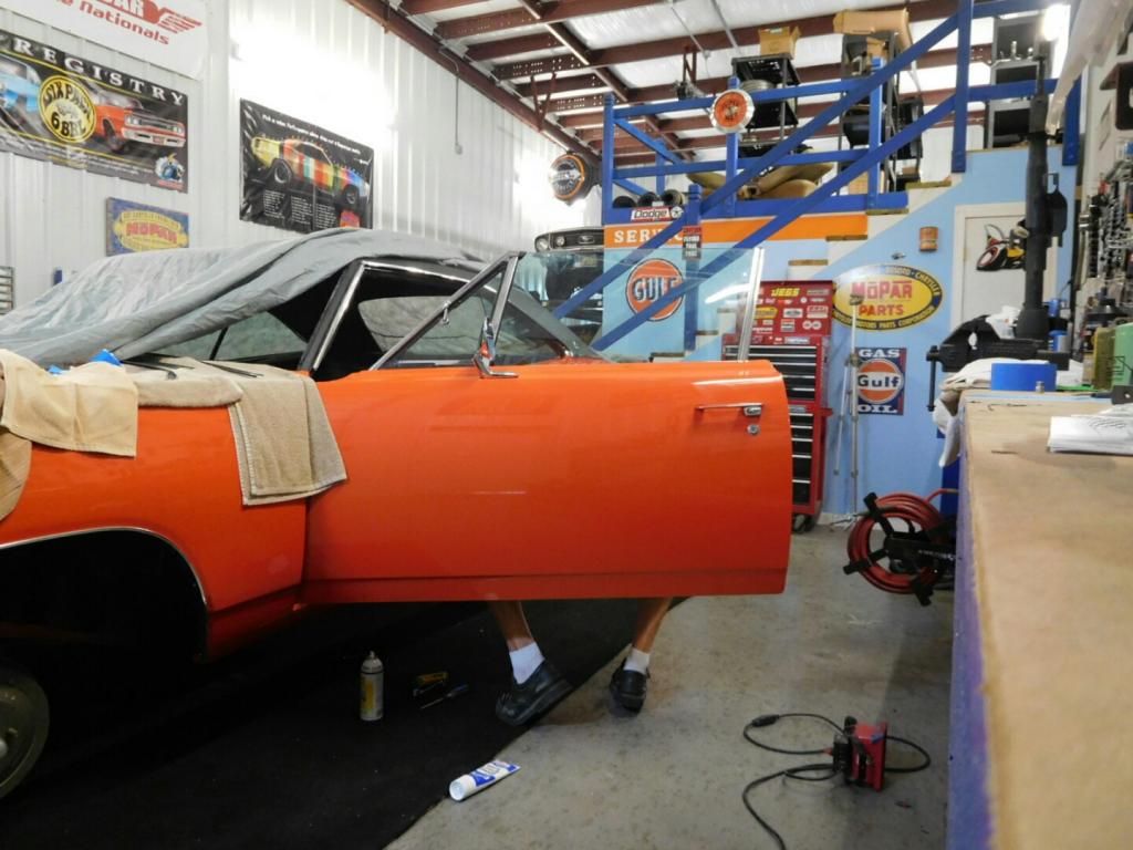

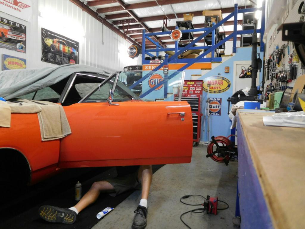

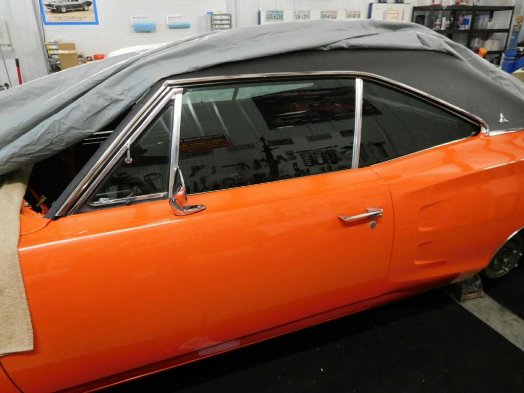

You know? I reflect back on the whole build and think to myself, &quot;Self? Wouldn't it be cool to have a few photos of me working on the car?&quot; And then I answer myself with a &quot;Yes...yes it would.&quot; And then I realize I do! [img]<<GRAEMLIN_URL>>/biggthumpup.gif[/img] Sort of puts the whole build into a more Quick Pick, 1hr photo, Instant Breakfast, Reality TV world we live in now. I thought putting in the door glass would be another great opportunity to get some action photos. As you recall, the original shattered into a bazillion pieces after some inappropriate persuasion in the front vent window channel. Here's some of my favorties of this monumental occassion.......
Below is the Taping of the Door.....almost like Taming of the Shrew, but having nothing to do with it. [img]<<GRAEMLIN_URL>>/hmmm.gif[/img]
Up next is an action series!! I'll never forget this moment....I was inside the door, connecting up the regulator, and as you can see, it's getting pretty intense!
Oh, and here you can see me adjusting the vent window to set the declination and inclination of the vertical axis....
...And a great shot here! So much detail can be seen in this one. I really hope these detailed oriented, step by step instructional, and Assembly Manual-like photos help someone out who's adjusting the door glass. As you can see, it's a tough job. Tough I tells YA!!!!
And the result....I'm happy to report the shuts exactly like it did before I tore the car down! And this time, no broken glass [img]<<GRAEMLIN_URL>>/biggthumpup.gif[/img]

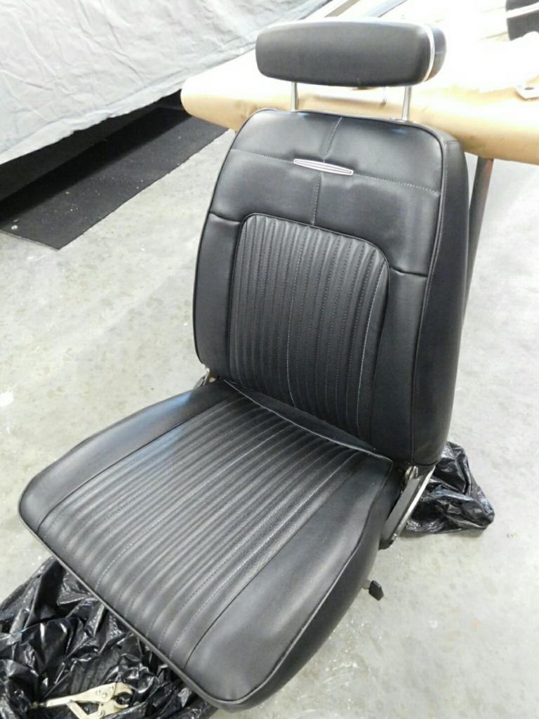

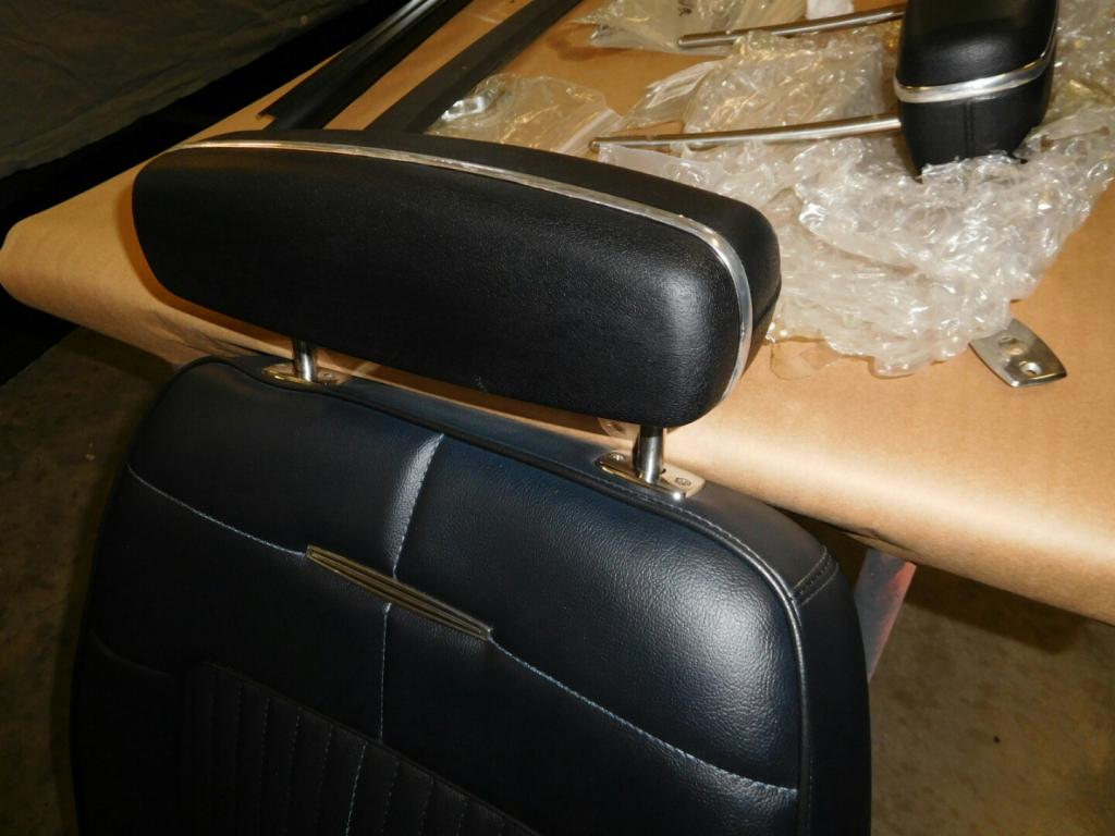

It's interior time! Dash, seat, steering column...they're all here! I figured the first easy thing to do was to replace the headrest bezels and headrest on my already covered Driver's seat. I recovered this when I got the car, which......HEY!??!?!?! That was 3yrs ago to the DAY TODAY!!!!!!!! [img]<<GRAEMLIN_URL>>/biggthumpup.gif[/img]
I'll install this later today since I have new seat riser spacers that just came in. They are 1/2&quot; thick spacers that go under the seat track and provide a thicker surface for the anchoring bolt to sandwich between the track and the floor pan.
New headrest installed with new bezels. The originals are OK, but they sort of lost their shape over the years and the chrome band around it is less than chromey.

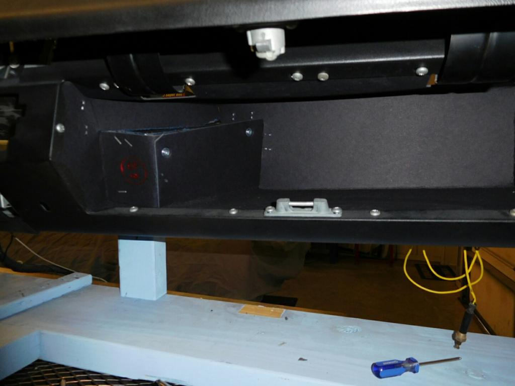

Dash is up next, and I am able to use all of the dash pads! The center has some scuff marks that I'm going to try and repair. If I can't do it, that may be the only piece that needs replacing.
Glovebox installed with the correct &quot;4F OK&quot; stamp....which, if you think about it...doesn't 4F usually mean NOT ok? [img]<<GRAEMLIN_URL>>/dunno.gif[/img] I'll get a better picture of the stamp on the next round of dash photos. Kind of hard to see with the flash.

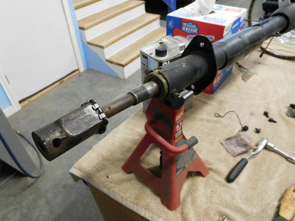

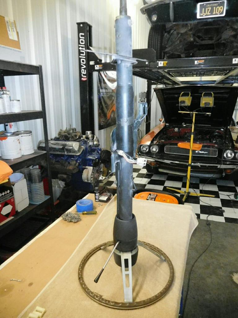

Steering column is on deck! The overall finish of the column is flat, or satin sheen and this is a textured coating. I'll replicate that when I paint it. The lower column bearing is in perfect shape! No play at all. Original turn signal harness part tag is still there. Also, all the tags on my harness under the dash have their original part tags installed except for one which I was able to buy.
Steering coupler is intact and never been apart! This, as most Mopar guys know, is about the biggest pain in the rear part to deal with. Instead of a regular rag joint, MaMopar decided to make this contraption with consists of a pin, two bushings, an internal retainer/spreader, a rubber seal with a metal retainer. I'm just wondering how this got approved by management? [img]<<GRAEMLIN_URL>>/dunno.gif[/img]
