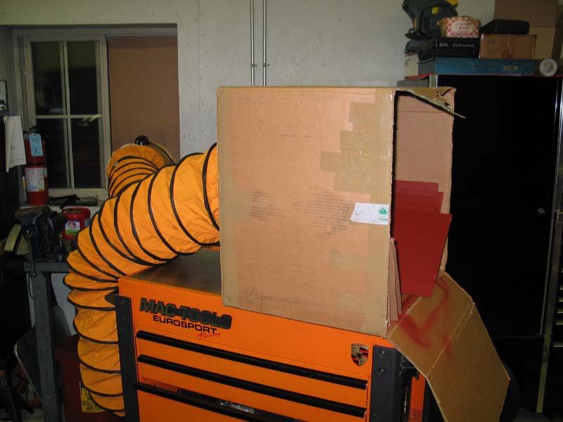

Lynn,
I have a 69 Camaro that should be painted soon and have been working for 6 months on getting the correct original trunk paint. I reluctantly have asked several of the best restorers for any tips and they are pretty tight lipped, as it should be, I am not paying for their experience or expense and that is their income. I respect that.
So like many of us I have to figure it out by trial &amp; error. I have good pictures of two cars to compare to. A 5000 mile 69 Camaro SS and a 35000 mile 69 Z, both very nice original trunk cars built at Norwood. I also compared the trunk of my 1970 Chevelle 36000 mile.
The first problem in comparing is using photos with different lighting &amp; different cameras. I tried to use the same angles &amp; flash in my comparisons. I had to paint inside so I built a simple paint box with a filter. Worked out great for indoors, no dust or fumes.
I had heard John Berlage’s paint was the best match, but after painting it I wasn’t quite sure so I bought Zolatone to compare. Johns instructions say to use a conventional siphon gun with a large primer nozzle. My gun has a 2.5 nozzle but it kept plugging up.
I switched to a body Shutz gun with better results but I was looking for a finer pattern so I adapted a nozzle to the gun. The factory probably used a pressure gun like a pressure pot but I didn’t want to buy one to try it, maybe the best results.
I was going to paint sheet metal samples but realized I would need too many so I used cardboard. I primed &amp; sealed them with Red Oxide like the factory used in the trunk.
You can get very different results with the air pressure and angle of the gun.
The photo “J-B box flash” shows how it looks painted in a box to simulate the different spray angles in a trunk. Right now I would say John’s paint has the best droplet size of the aqua but the way I am spraying it comes out a little too dark &amp; lumpy. The Zolatone is too light &amp; flat, doesn’t have the texture like the factory paint did. Tomorrow I will try using the Zolatone as a base coat with Johns paint over it. I think that might be what I am trying to achieve. I will take all the samples and match them to the 69Z on Saturday that will be the true test. Sorry for the long post. George.

Camaro trunk comparisions, Seven samples, John's paint in box.

George:
Don't apologize for the long post. This is EXACTLY the type of info I am looking for. I fully understand the different looks depending on lighting and the like.
PLEASE CORRECT ME IF I AM WRONG, but it looks to me like the tint of the Berlage is the closest. It is just a matter of getting it on the surface in such a way as to get the texture and pattern correct. What do you think about spraying some dp90lf under it instead of the Zolotone as a base?
Seeing that you have gone to this much trouble, I will buy a quart of the Berlage, and purchase a cheap pressure pot set up with the biggest tip I can get up to 3.0 (you said your 2.5 clogged, so i plan to go a little bigger - OR IT MAY BE THAT I DON'T NEED A LARGER TIP ON A PRESSURE POT SPRAYER - MAYBE SOMEONE CAN TELL ME????). There is no sense in one guy having to do all the r &amp; d. We can then compare samples. I do have the luxury of leaving some of my original trunk untouched until I get a good enough match that I can do the whole thing. Should make it a little easier to compare.
I agree with respecting the big dogs as far as trade secrets, but also believe there has to be a way for the hobbyist to replicate this look, and believe that as a hobbyist, I ought to share all I can. That is how I got most of my info, from guys like you guys. I can't imagine that GM spent more than a minute shooting the spatter, if that long.
Thanks again. Will go order the paint and a cheap pressure gun set up tonight. Currently experiencing relatively cold weather (nothing like Canada, but barely breaking freezing) for a while, so can't actually paint until I get some decent weather.
