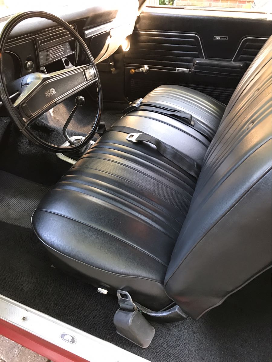

I cleaned the ole Chevelle up today, pulled the seat belts from under the back seat and installed the front belts. The rear belts should had been soaked in a bucket of oxy clean but that is for the guy that restored this ole girl. I drove the car 8.5 miles and it drove ok. Tightened up the steering box drives much better but the tires are shot.

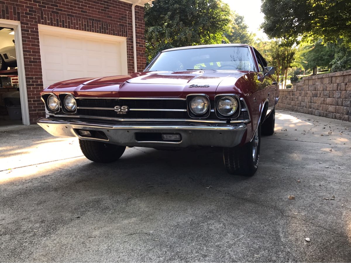

I have been racking up the miles on this car. Really fun to drive, and different driving experience with the full frame as compared to the uni-body cars. I still have not pulled the rear end cover but I believe I have changed my mind now that I have put over 100 miles on the car. I believe the 3.31 gears are in the car. The engine just does not seem to be revving that high at 60 mph like it should if it had 4.10 gears in it?
