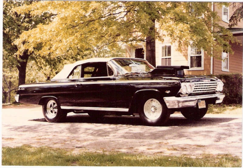

I had tricks on my '62 with tubeless tires. Never had a problem. Always held air.
Verne

Grady now owns the Cragars and slicks
Verne
Attachment 105821
Now that was a sweet 62 Verne. I assume you moved it along somewhere...or do you still have it.

Still have it. Replaced the hood, got rid of the roll bar and it's back on the street with an '09.
