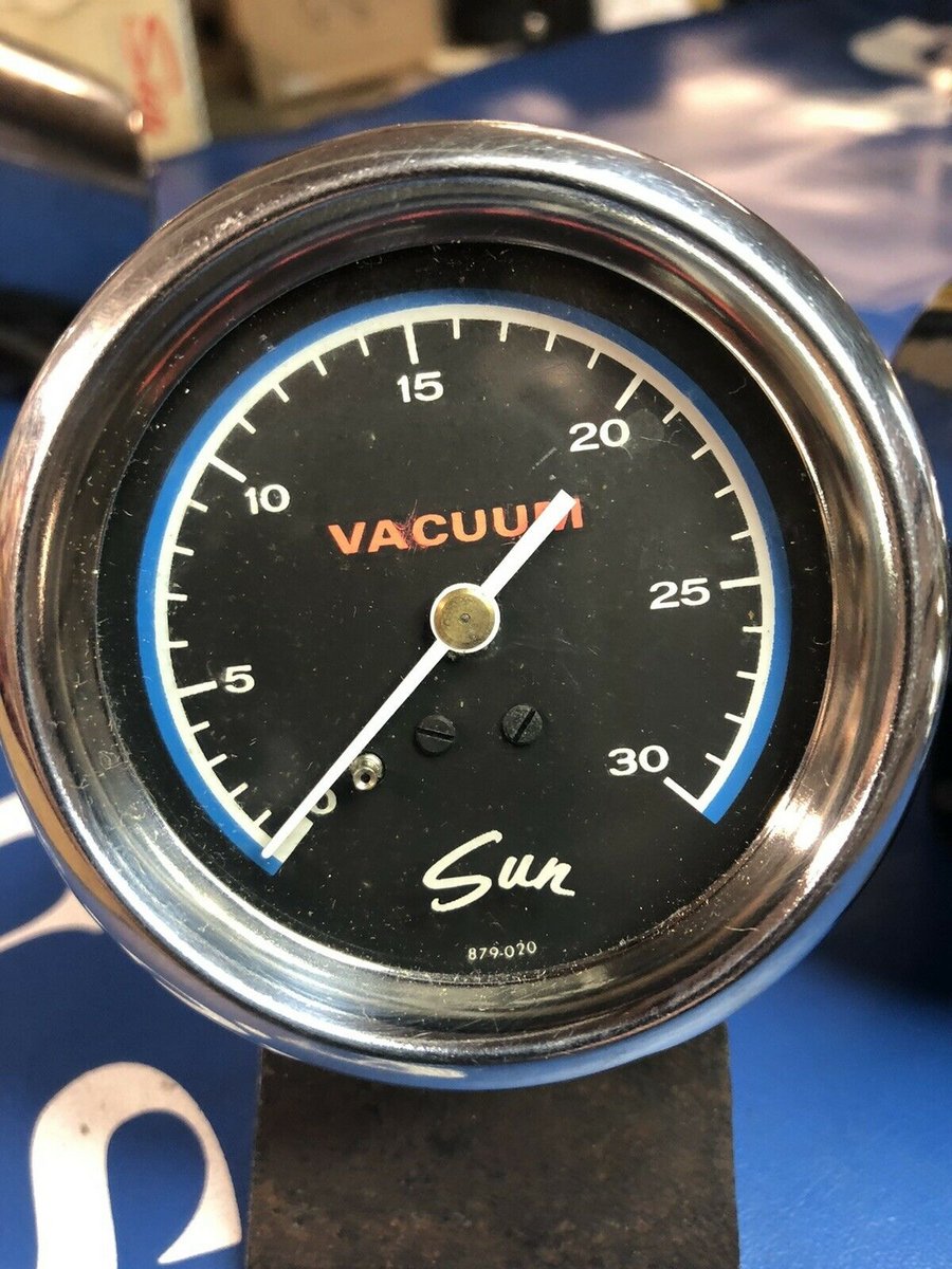

Parts are starting to come together for this build. First off, Bergy was kind enough to hook me up with enough parts to rebuild the V75 liquid tire chain option including a case of traction compound. On the transmission front, Jeff Collins is building me an M23Z with a 2.99/1.87/1.35/1.00 gear ratio. For the shifter, Eric Davidson is rebuilding a stock 3138 shifter for me and I'll keep the inside somewhat stock looking with the factory console.
I will however add a couple of gauges to the cowl panel and one to the column as I have purchased SUN Fuel and Vacuum gauges with 2-5/8" chrome cups and further scored an NOS NC-5 Cup and SST 10K tack for the steering column. Finally I also managed to scoop an NOS Hurst line loc kit so things are progressing well on the parts front. Next up is to secure a nice set of original Torque Thrusts or perhaps a set of Fentons to round out the look I am going for.
Anyone have a nice pair of Fentons or M/T stashed away? (Oh Grady!)
