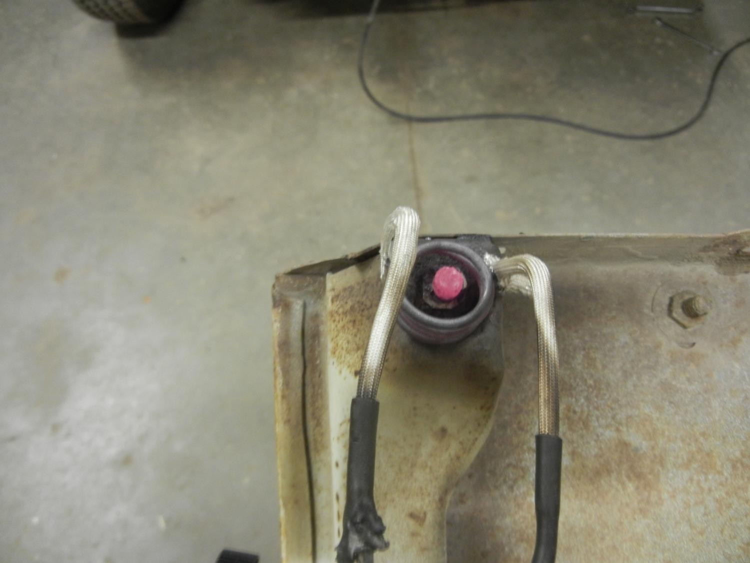

Yesterday had it's high and lows for certain. The heat riser gasket was leaking. I had been soaking the nuts on the manifold studs for a couple of weeks. 2 of the nuts on the passenger were cooperative (with heat). 1 of them was not.........
I have had luck with welding a nut onto the remaining stud.
That was not the case here. Soooo.....pull the manifold and sharpen up the bits. This only killed half of the day yesterday. A victory was had though!

Can't believe you don't have an electric torch... this tool has saved me many yours of frustration with frozen fasteners over the years. Guarantee, it would have heated that nut in under 60 seconds and broken the rust lock to spin off.
That's exactly what I have. I gave up on a conventional torch long ago after I discovered the inductive units.

Seems odd that the heater wouldn't loosen the nut, leaving the stud in the manifold. When it didn't turn with moderate force, did you heat cycle it 3-4 times more ? With a stud like that, I never use a power tool until I can get it to move by hand with a ratchet. I'm not as good as you with drilling out broken fasteners and will test my patience level with attempting to remove without breakage.
