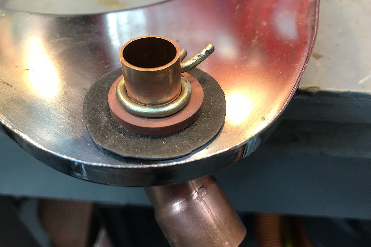

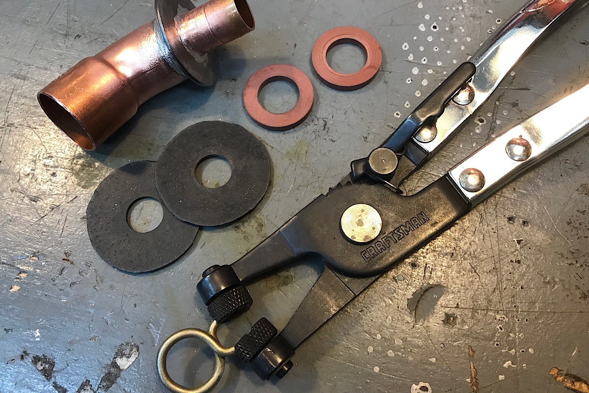

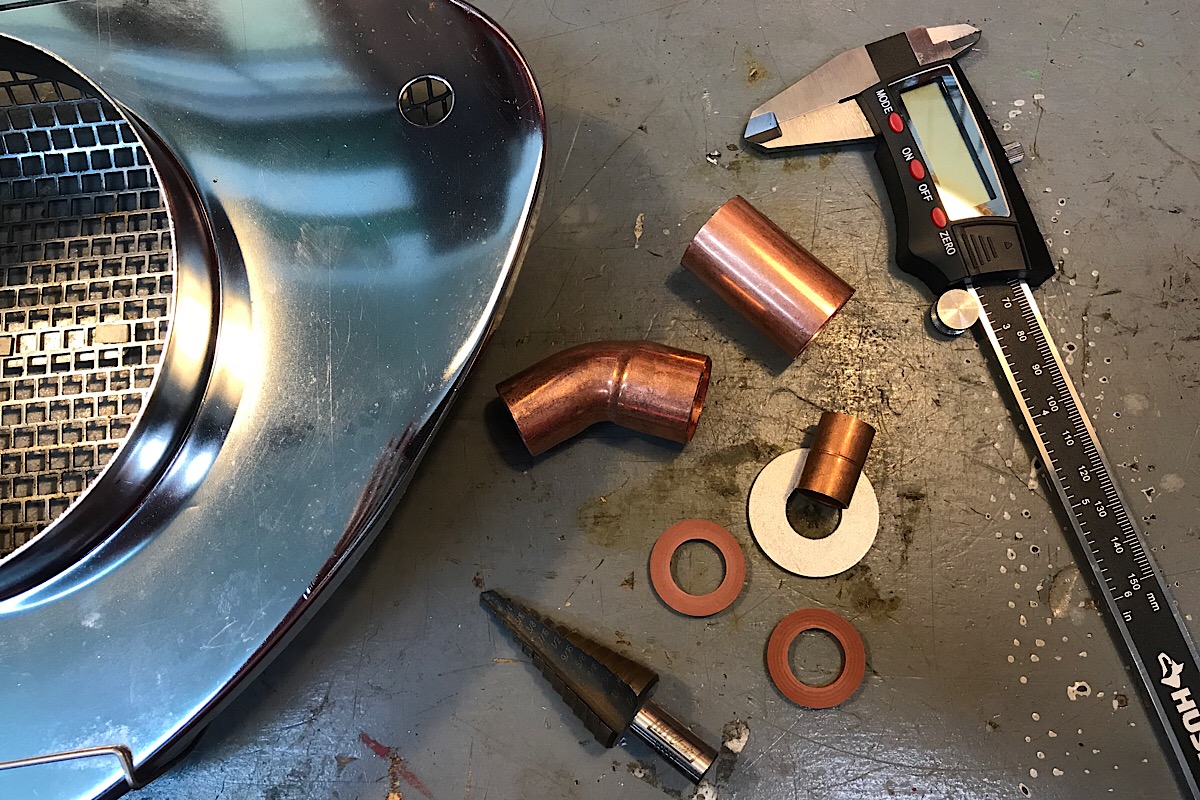

So I am wrestling with which air cleaner to go with. I see a bunch of round “fly-eye” a/c’s used and was hoping to find something different that looks good. The below triangular type popularized by Weiand, Ram-Flo, Edelbrock, etc. may be a bit late to the game for my ‘69 wrt when they were introduced, so I will have to consider that (suggestions are welcomed). If I use this Ram-Flo I will have it replated so it pops. Regardless of which I choose, I want to address PCV on the passenger side of the engine and will most likely use carb vacuum to take care of it. So, just like I did with the Roof Deuce I used M22Mike’s (Mike A) inspiration to create a junction between the VC and the air cleaner and I thought I would post one way to take care of this. I like simple so I used copper and steel so I could get away with soldering. I may paint this black eventually although there is a definite steam punk vibe going on now...
Sam...

  #478
Old 04-25-2018, 12:03 AM
m22mike's Avatar
m22mike m22mike is offline
Location: West of CAK
Posts: 5,001
Thanks: 766
Thanked 837 Times in 403 Posts
Dang.....your hired...

  #479
Old 04-25-2018, 04:00 AM
Posts: 9,319
Thanks: 31,871
Thanked 4,411 Times in 1,873 Posts
----JFO, (just for me) absolutely better than Fly-eye! Hope the haters don't hate......Bill S

  #480
Old 04-25-2018, 10:03 AM
DW31S's Avatar
DW31S DW31S is offline
Join Date: Dec 2010
Location: Maryland
Posts: 2,103
Thanks: 387
Thanked 296 Times in 190 Posts
Nothing here I don’t like! Attention to detail is “off the charts”!
