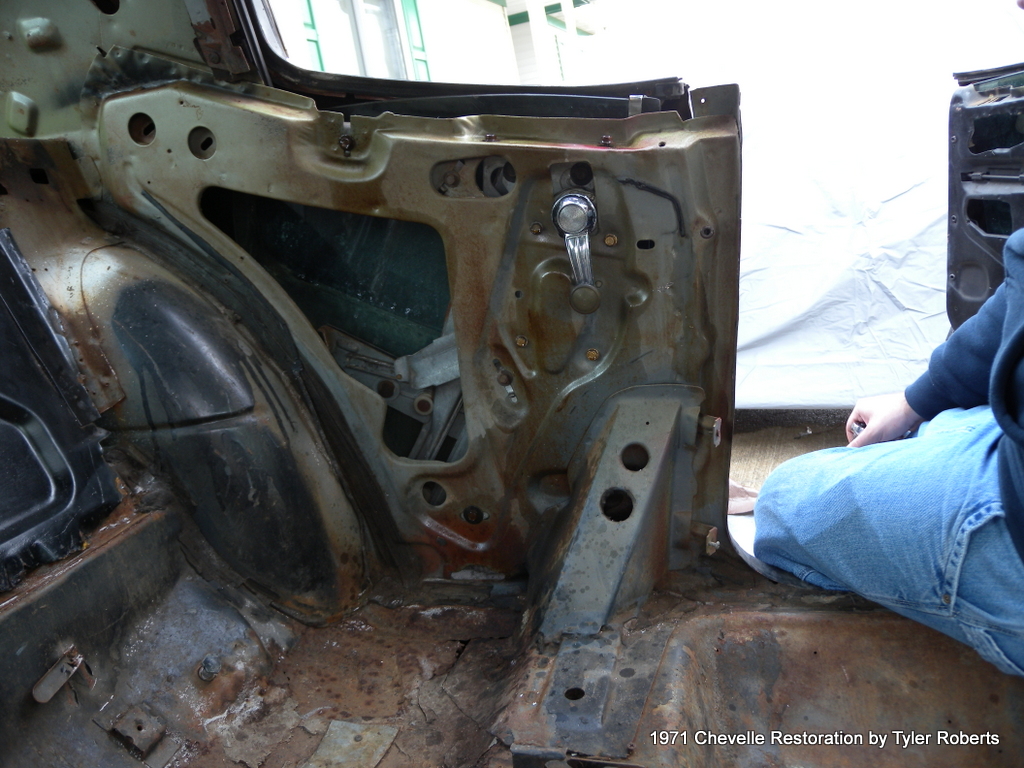

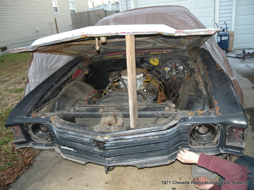

Today was a nice day, Tyler just got started late. First up was to take everything off and drop that axle on the blazer.
I little PB Buster and wire wheel on the die grinder to clean up the rust and gunk from the threads. Everything when well until the nuts holding the springs to the axle. Did not have a deep well the right size.
Good excuse to get more done on the Chevelle. Pull the B&amp;M Shifter and the EEC box.
All the glass is out except the windshield.
Nova Research Project at chevynova.org

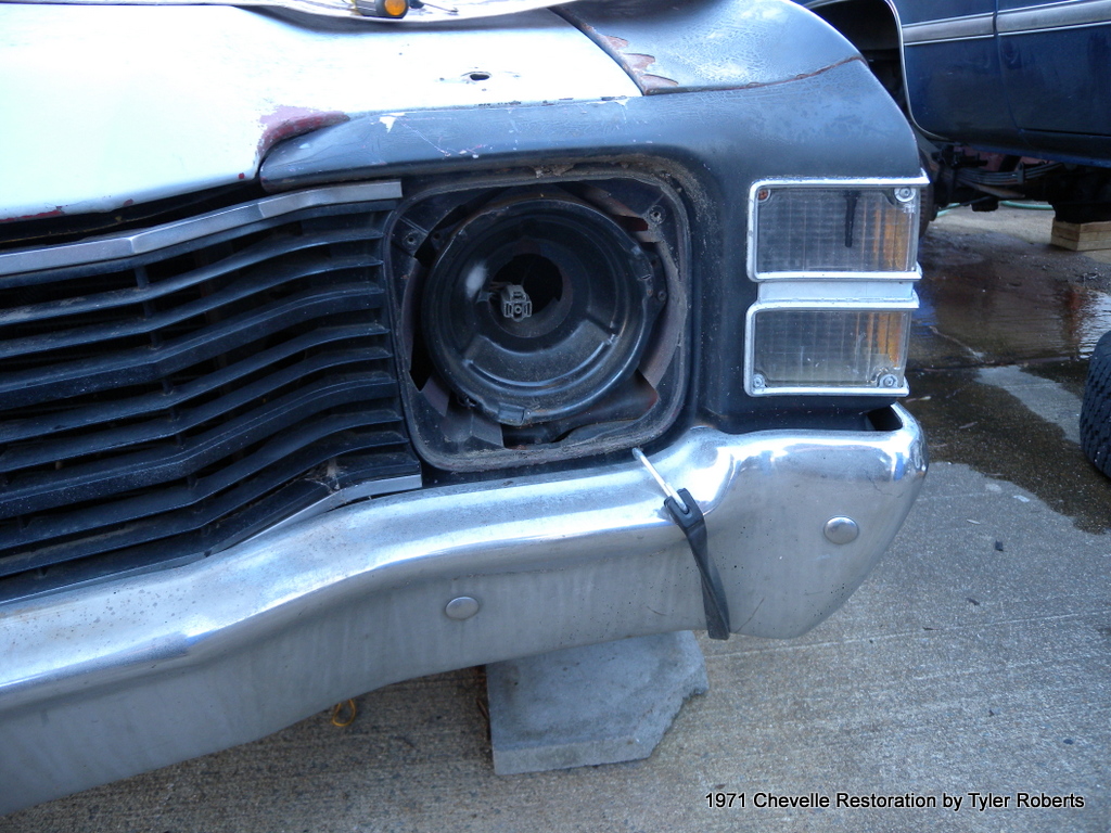

Shouldn't these park lights have reflective silver background?

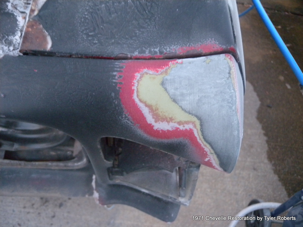

Time to have fun. I had been using the soda blaster and let Tyler give it a try on the Chevelle.
Then ran out of daylight. What a rainbow looking car.....
Original primer,
Original Green paint,
More primer,
Red paint,
Black paint,
and yellow on the firewall and core support.
