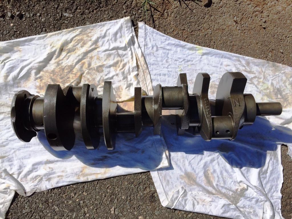

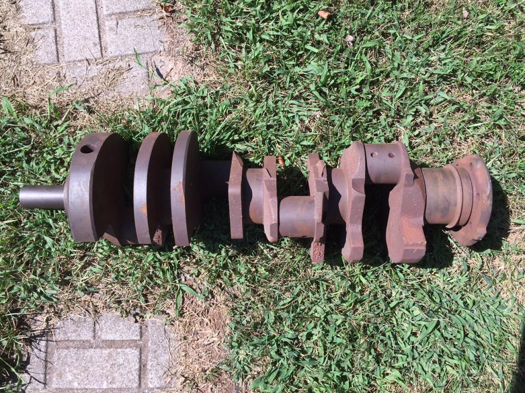

It works wonders. This was the crankshaft I bought used for my 455. Before and after:

Wow, looks great. Did you spray it will anything afterwards to stop the rust from coming back?

No, actually I immediately brought it to the machine shop for them to check.Ended up cutting it .010/.010 and then balancing it. The machinist was amazed at how well it cleaned up. It's running in Gramma's Firebird now.
