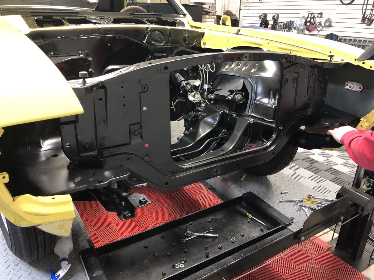

The glass installation went well on the driver's side today, and we then went ahead and blew apart the front end. This will allow me to better address the gaps on the doors and fenders and also allowed me to pull the heater box since I forgot to install the dreaded Y duct. We then tested the new blower fan, hooked up some restored heater controls and everything snapped right back into place before we packed it in on the day. I now have some business matters to deal with for year-end so we'll see you all again in 2021.

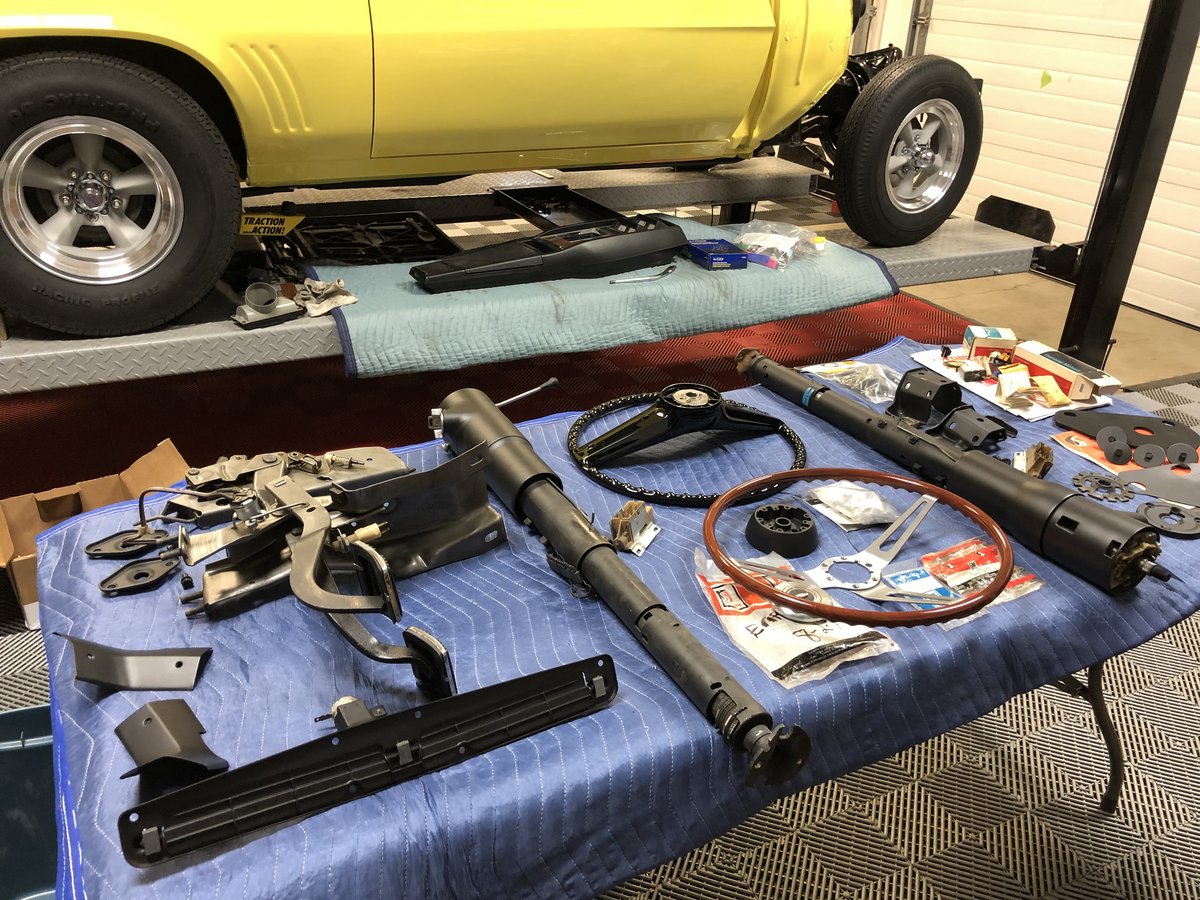

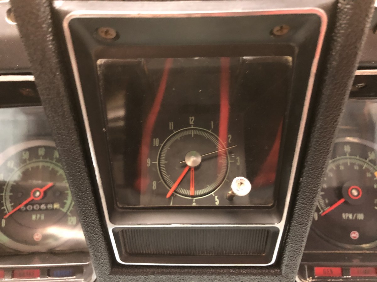

This afternoon is a continuation of some bench work as we got started with some clean-up of the instrumentation carrier, the gauges, and the pedals yesterday. Soon I'll be ready to install this re-coned speaker, the AM radio, and the rest of the hardware into the dash. I'll continue getting all of this ready today as it won't be long before it's being called for. Might also get the wiring harness into the car today. Happy new year's day everyone!

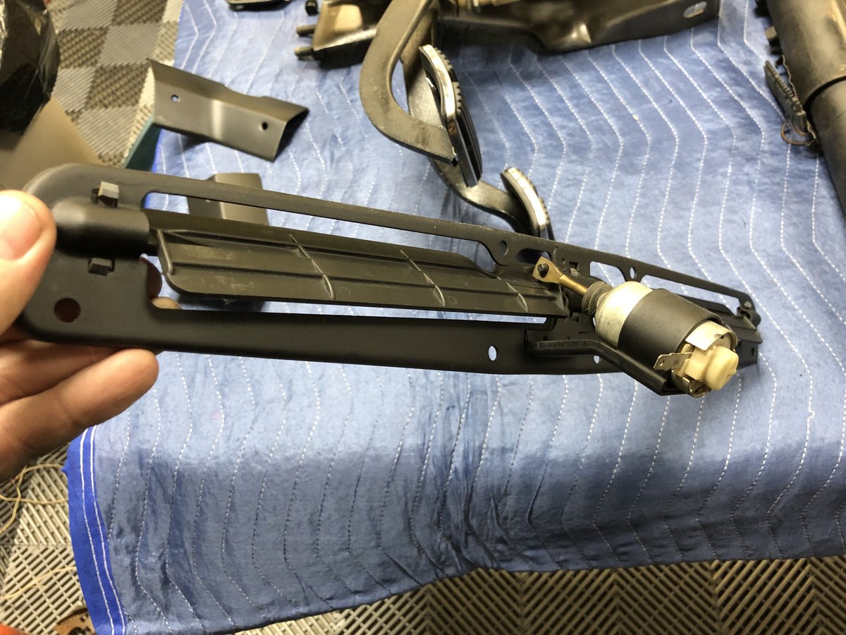

No seriously...been doing a lot of the boring stuff for under the dash. Like cleaning and detailing parts, rebuilt and installed the wiper system, restored a steering wheel, redid a tilt column, clear coated the pedal carriers, cleaned and painted the cowl frame, sorted out a bunch of wiring harnesses, installed the main dash harness, and got a spare non-tilt column painted and ready to pair together with a restored steering wheel that I want to sell, and also dry set the windshield so I could mark the lower tabs and redrill the holes for the stainless trim. Yup...been a little busy.
