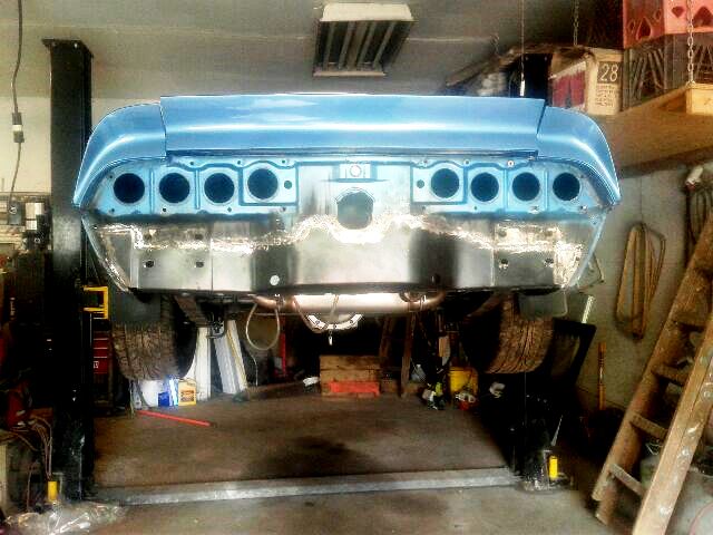

I have the Gramma car back at the local shop. He had an opening for some quick work and told me I could bring her down after i pulled the fuel tank out. The original inner and outer rear valance panels were rusted at the bottom flange from winter use by Gramma back in the 1970's. It was a terrible design that just trapped the salt and mud from the tires and held it in place with no real access for a hose to flush it out.
When I had the car painted 25 years ago the repro panels were not available. So I had to wait a couple decades for parts availability to catch up.
Happily, Santa brought me these two panels a couple Christmases ago. The shame is that we only needed the lower six inches or so of the tail panel so 75% of that $300 panel is going to waste. He was able to remove the inner panel at the factory welds and was installing that as of today.
I am getting all the underside stuff done in advance of a future paint job. This way when it comes time for paint, it will just involve sanding, massaging, and painting and no rust repairs. (resulting in a briefer sentence in bodyshop prison I hope).

With as clean as Gramma car appeared, I am quite surprised it had such extensive rust back there--you gave a good reason/explanation though.
Thank you very much for the repair pictures, and if you get any more, maybe close-ups of the welded edges/seems, I'd like to see them for future reference.

The rust really isn't "extensive" at all. On the entire car, it is isolated to only those two rear sandwiched panels. These cars were known to evaporate rapidly once exposed to salt. We rescued it from daily winter driving after only a few years of use by Gramma and then my brothers. The lower portions of the rear frame rails are beautiful on this car - another major rust prone area to look for in case you're ever shopping for a second gen F-body. The other area is under the lower corners of the windshield where the water sits and puddles on top of the cowl.
The body man has the new outer panel installed today. Working fast!
