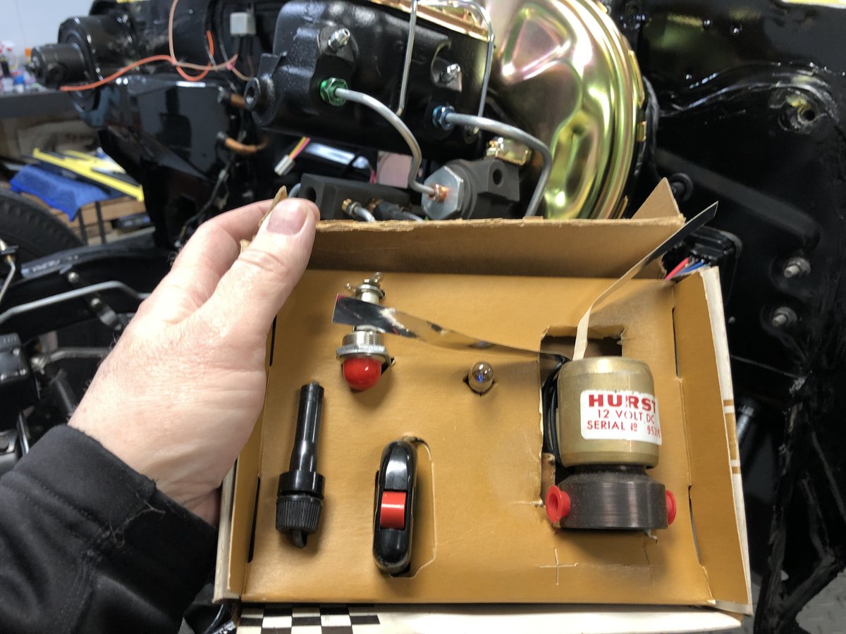

Finished a little wiring around the engine bay, completed the booster installation, the master cylinder, and all of the restored valving. Also seen here is a Mr. Gasket throttle lever bracket that was sent up by Mr.4Speed and replaces the stock plastic version on the firewall. Next, I'll coil up a couple of lines to plumb the Hurst roll control to the inner fender area for mounting later on. Should have the motor ready to install in the next couple of days.
