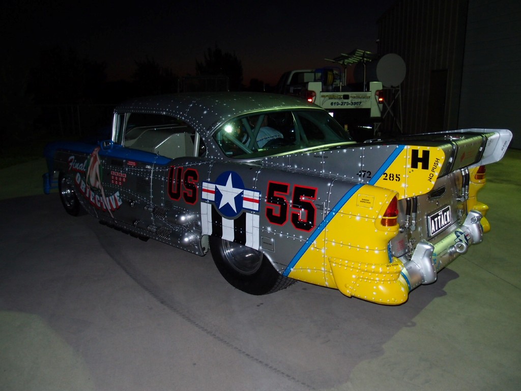

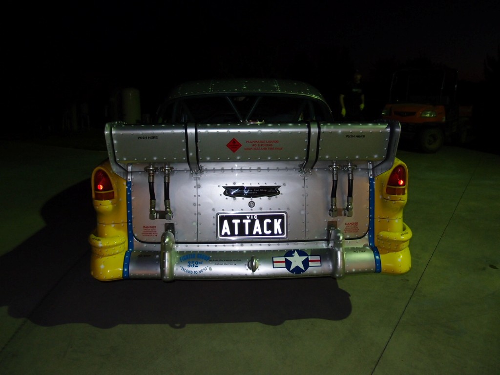

Charley, do you still have that beast?
  #60
Old 12-05-2011, 11:53 PM
StealthBird StealthBird is offline
Location: Chicago, IL
Posts: 1,127
Thanked 95 Times in 43 Posts
Default Re: How bout a few Vintage aircraft photos?
Charley, that THE coolest car I've ever seen! [img]<<GRAEMLIN_URL>>/beers.gif[/img]

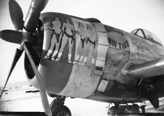

DVD's for Musclecar fans! MusclecarFilms.com
