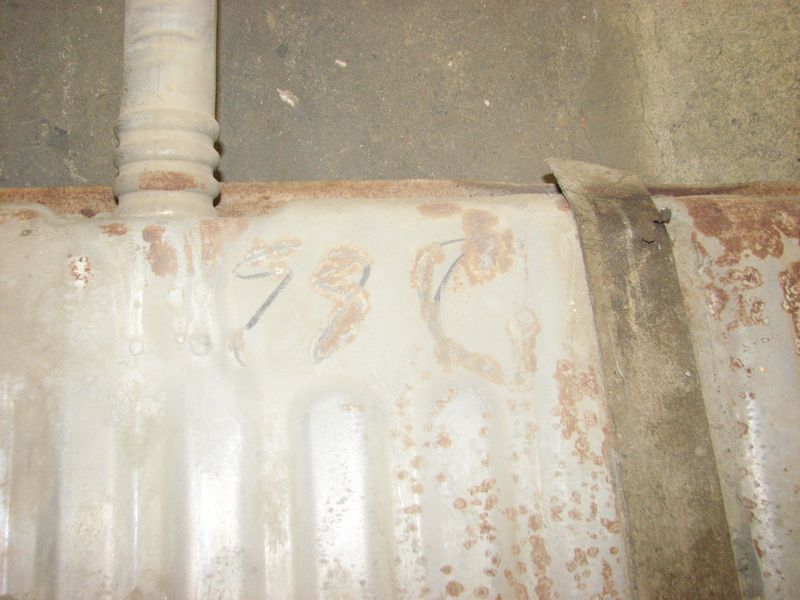

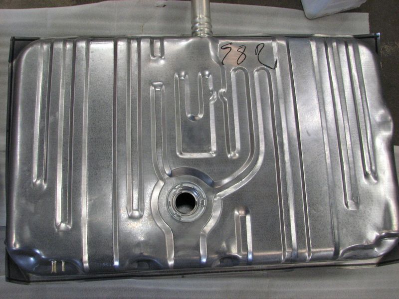

There was no saving the original so we opted for second best which is the Spectra tank. The 70 Chevelles are almost identical with minor exceptions. The 69 tanks are not near as close but will have to do until or if I can locate an original that is in mint condition. Experience tells me that will not happen so this tank will have to do.
The only inspection mark I found on the original tank was the number "982" written in black grease pencil. I traced the original and replaced it on the new tank exactly as found. This number is normally in the top left corner of the buildsheet which unfortunately I do not have.
The reproduction pads you buy today for the tanks are nothing more than thick foam so I made my own laminated version like the originals using a slightly different product but with good results. The noise strips were made from heavy gauge roofing tar paper. I then purchased the stencil kit and screen printed it onto the tank. Very tedious work requiring some touch up.

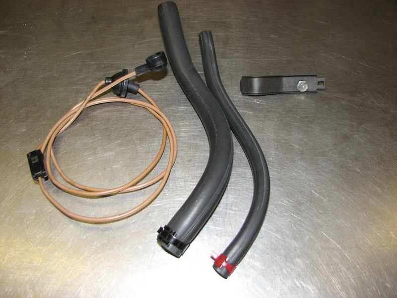

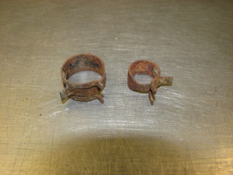

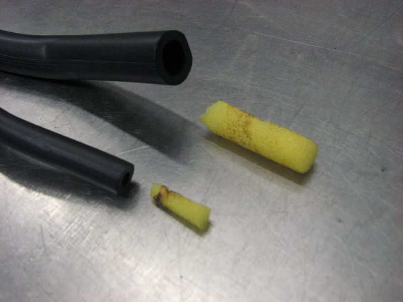

The fuel vent tubes were original so I simply cleaned them up, inserted new foam filters and restored the original square tipped clamps. I found remnants of the old filter material in side the vent lines so using a heated bullet casing I hot cut new vent filters from foam from a garden tractor. After closer examination of the hose line bracket it looked to have been original phosphated so I re-phosphated my original, restored the screw and the rest of the electrical and hardware.

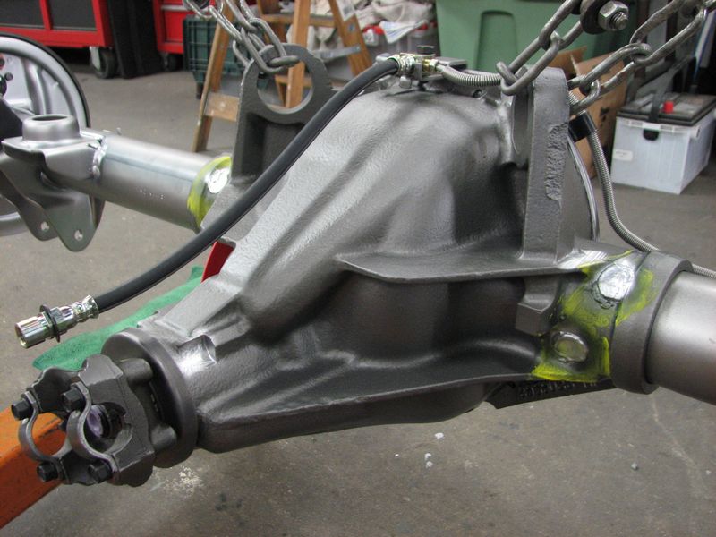

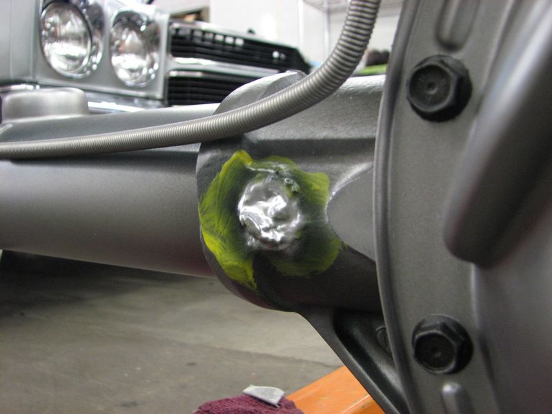

I worked all weekend on the rear KQ differential (already partially painted) to get it assembled, finish painting and detailed and finally installed it tonight. As you can see, I am trying to replicate what I found exactly as I found it will minor additions such as inspection marks I know were on the majority of cars but were not visible on this car.

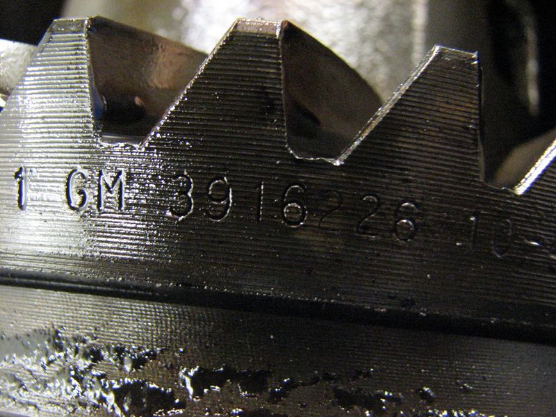

The gears were dated 2 67, almost two years before the rear assembly but from what I could tell during disassembly the rear had never been apart. Seems like a stretch to me but that is what I found.

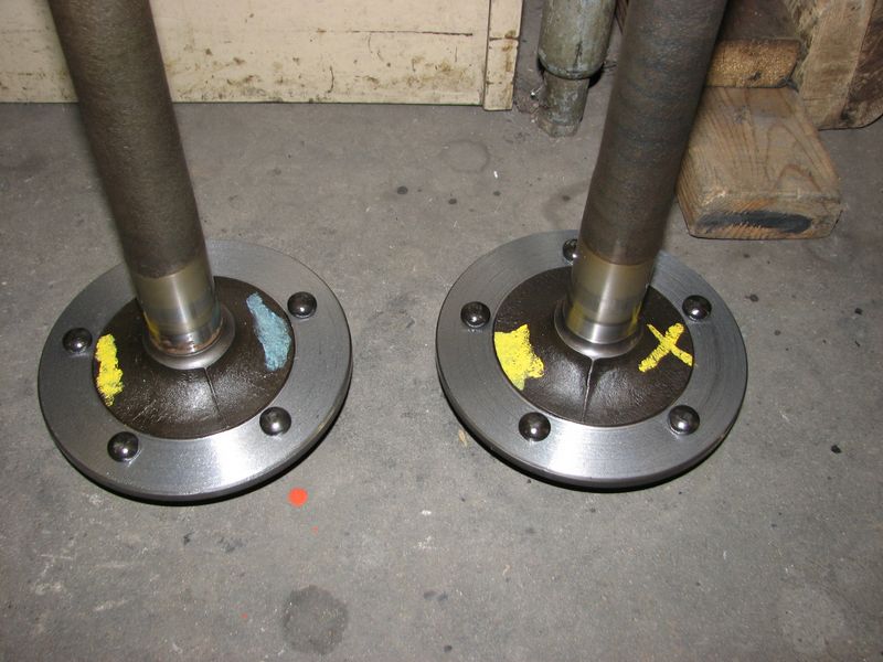

The pinion flange was restored with the inspection marks that were found. Yellow on the side of the flange and mauve on the end of the pinion.

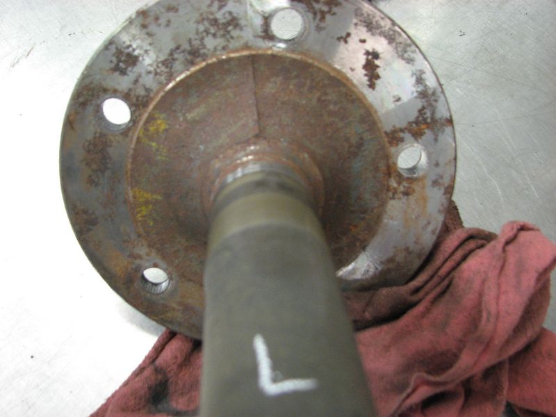

The axle shafts we cleaned and the studs pressed out and restored. I then ever so slightly turned the face, back and edge of the axle flanges after documenting the colored inspection marks I found. These were replaced exactly as found.

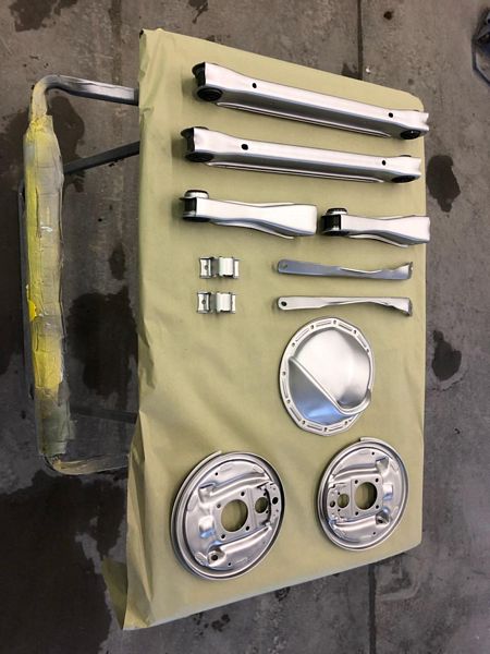

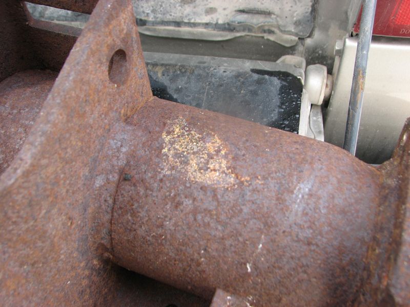

There were many yellow inspection marks on the differential and are what I normally always find on them. I should note first, this is a Baltimore car and more often then not the entire rear suspension as well as the crossmember is natural steel. Obviously there were minor pits in the steel axle tubes so I had to have bodywork done on them so instead of leaving them natural we had to replicate them in paint (Jamie did the initial bare steel color coat). I then went back and recolored some areas which consisted of one color for the tubes, another for the steel shock and spring brackets as well as the backing plates and rear differential cover all being different types of steel and/or manufacturing process necessitating slightly different colors. The center section was natural cast iron. All the colored inspection marks were replicated. I applied the yellow around all the plug welds then heated the plugs up to burn off the yellow around them and colored the plugs to replicated fresh welds. All the welds on the differential and crossmember were replicated to look like fresh blued steel.
I also replicated the cold rolled steel tube welding joint and replaced them in their exact location that they were originally located in. I likely have over 40 hours just in the finish work on the outside of the differential housing, axles and brakes.

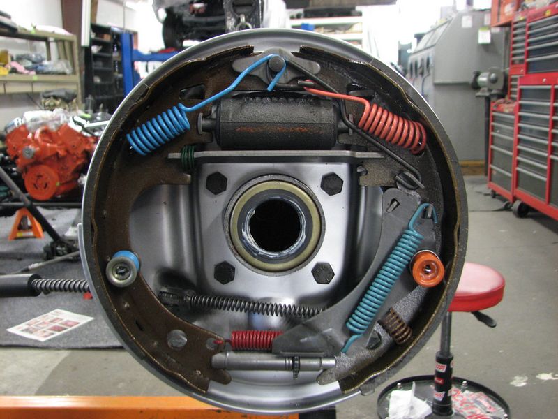

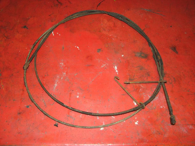

Here the rear diff is installed into the chassis and everything hooked up. I have seen the orange paint applied to the brake lines several times in the past (on 1970 cars) and found them on this car so I replicated them. All of the e-brake hardware and cables are original to the car and have been painstakingly restored back to original.

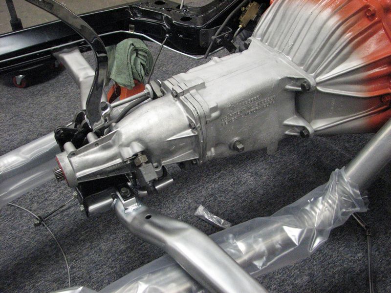

I also took the time over the weekend to install the trans into the chassis and attach all the peripherals onto it as well as finish off the simulated bare steel crossmember. I still have some inspection marks to add to the shifter but you get the idea.
I then added the car's exhaust manifolds onto the engine and painted the orange around the flanges to simulate a new engine with a little run time on it. The engine is painted with a custom mix single stage gun sprayed paint for durability and longevity.
