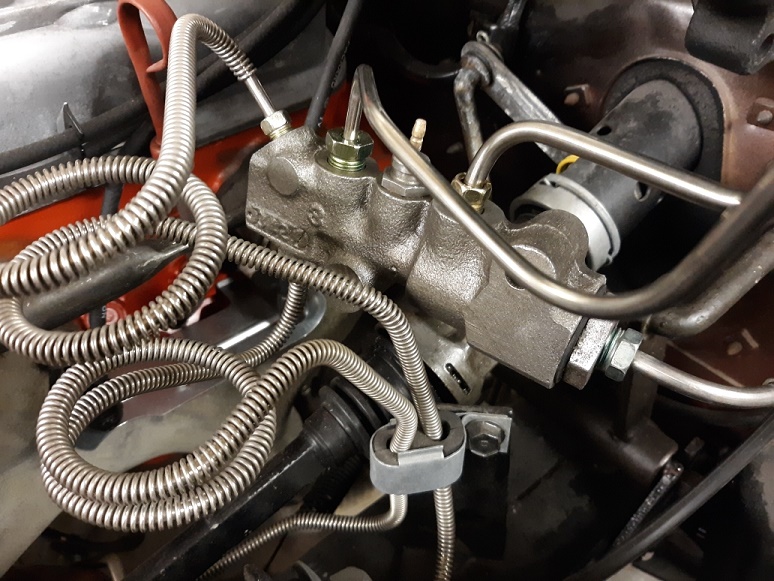

Update on things.......got a call from Karp's this afternoon after 8 weeks and the brake distribution valve is not rebuildable, they can't get the front half apart, which explains why I could not get fluid to the front calipers. Sooooooo if anyone out there has a cast iron distribution valve for a March 72 Kansas built Chevelle with front discs I am interested....looks like the one pictured below. I will also post in the wanted section.

I had a similar looking "BENDIX" brake valve rebuilt for my brother's 73 Z28.
The company had never done the style before SO I sent 2 valves ONE for them to experiment with and the original from the car. Told them I didn't care what they did to the additional valve, I didn't get the "experimental valve returned but did get the original rebuilt for about $100. I know of at least one other Nasty Z28 board member who also had their vavle rebuilt by Old Auto Restorations.

Jake I could not find the one I have somewhere.....I did remembered I have a frame from an Arlington built 72 W Code January Date that you are more than welcome to if you would like to give it a try.

Sure! Thank you very much. I'll PM you with my information. Appreciate it.

Big shout out to Joe Farrow (72convSS454) - he found a valve and sent it to me no charge. Thank you very much Joe! Much appreciated.
Off to the rebuilder's in hopes we can make this one work.
