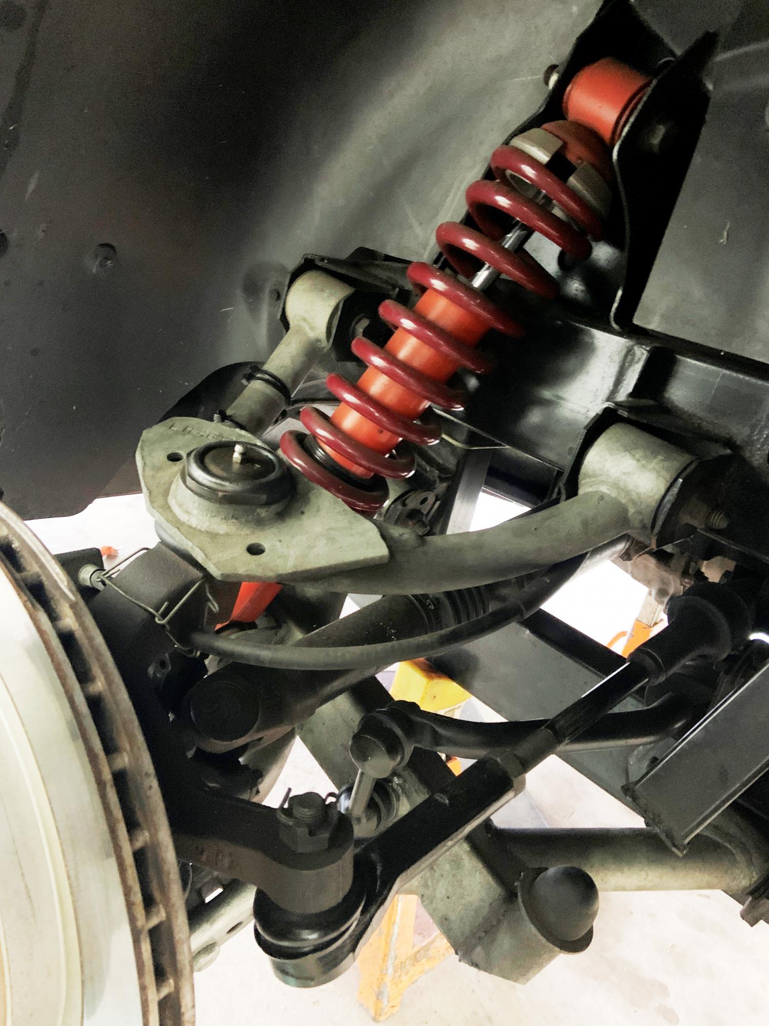

Here's the suspension details. The factory installed, fixed spring, Koni shocks were sent back to Koni in 1993 and they installed the adjustable spring perches for aftermarket Eibach springs.
I have been on the phone with Koni and Eibach this week trying to find the correct spanner wrench for adjusting the spring heights in case I ever want to mess with the settings. Back in the day I uses a 5/16" drill bit inserted into the adjuster hole in order to spin the spring perch. Not too easy with 500 lb rated springs. Neither company makes the wrenches so I had to search to find an old style round tip spanner for a 82mm perch. It should arrive tomorrow. All the modern perches now employ a square adjuster slot and use a flat, hook style wrench.
FYI, In 1996, the Gen 2 suspension replaced everything you see here with forged aluminum control arms, different shock/springs and a totally different articulation geometry that made the car much easier to keep in a straight line and much more forgiving to newbie owners. It was a night and day difference. They also added airbags, roll up windows, and actual door handles on the outside of the car. Simply preposterous, I tell you!

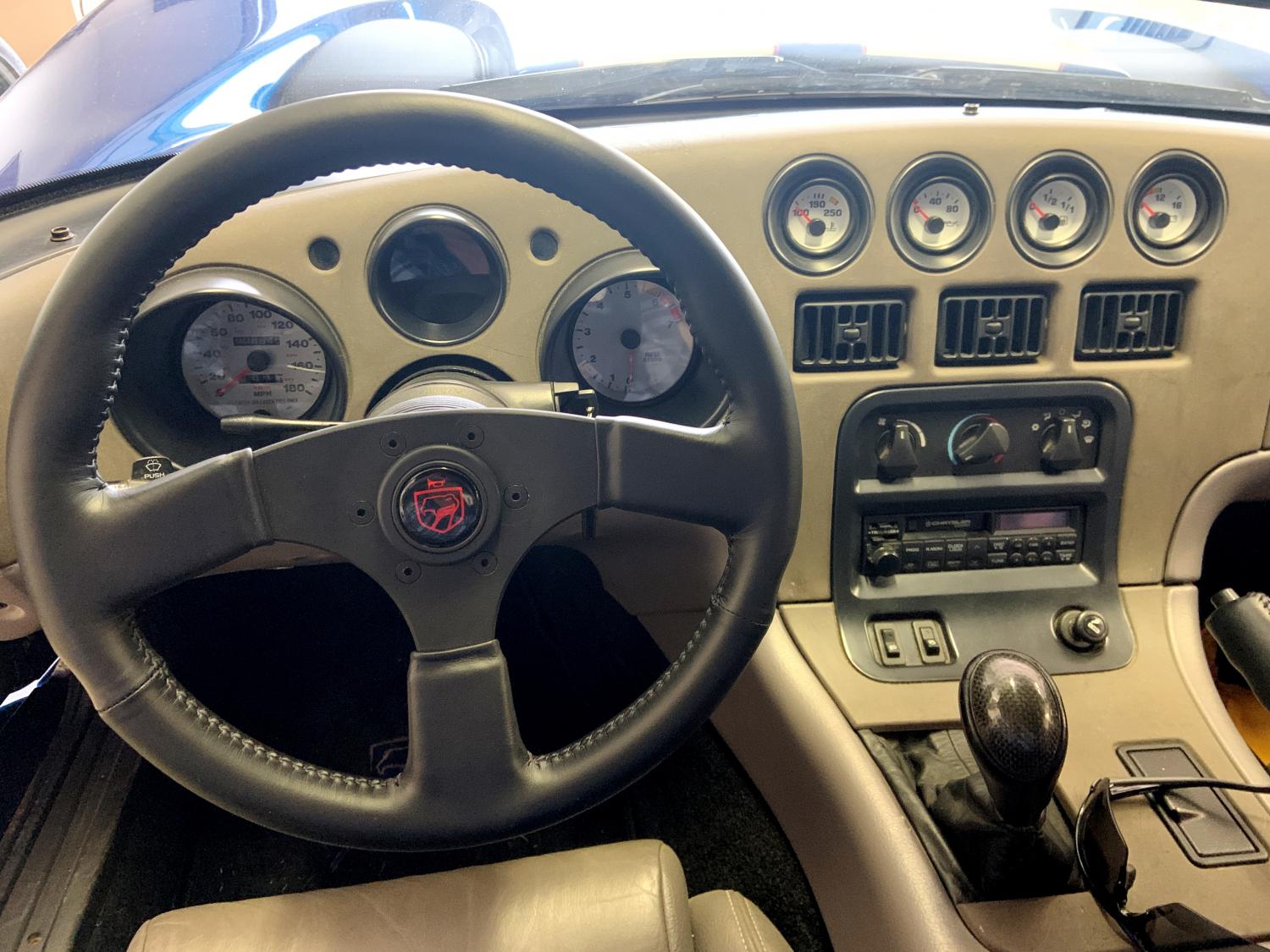

My early birthday present arrived!
An NOS Gen 1 Viper Steering Wheel still in the box. My original one has all sorts of scuffs, nicks, and scratches in the leather from 30 years of abuse. I'll retire the original one up into the storage closet for safe-keeping.

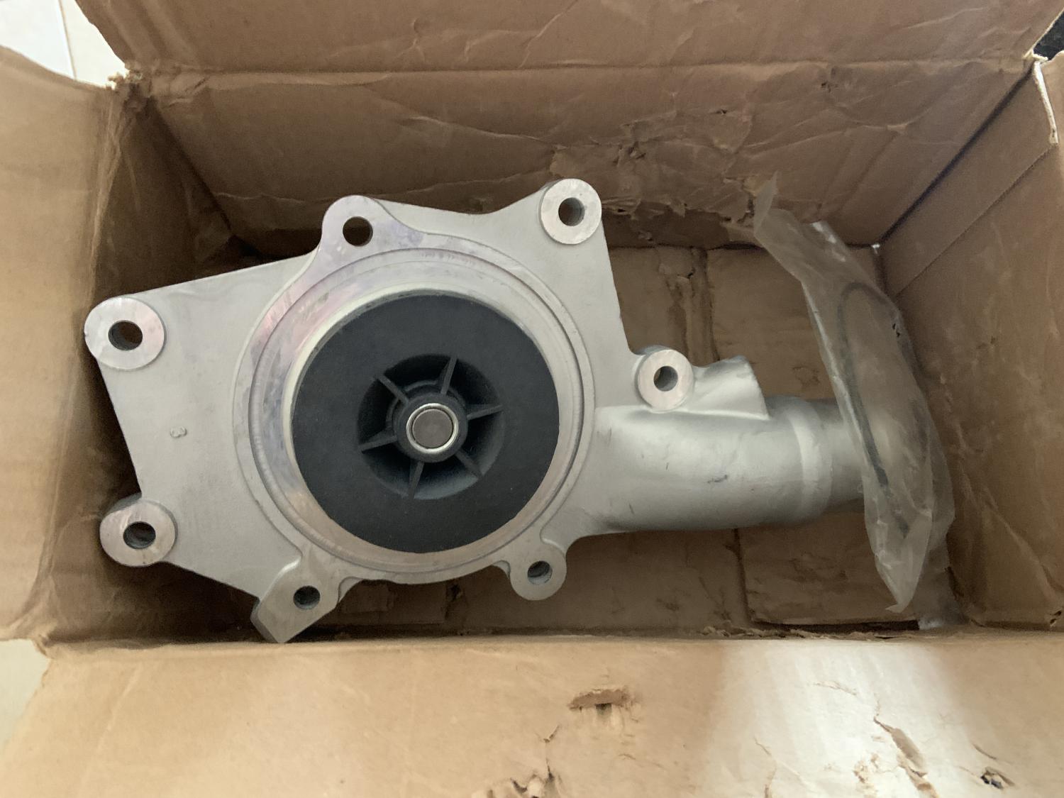

I've started hunting down extra spare parts for the car when they pop up cheap on rockauto. They actually have some dealer closeouts of the early Gen1 front and rear inner tie rods. TRW units for $11 each as wholesaler closouts. I got four of them. They still have some left. (BTW they're actually a Dodge Dakota truck part!)
And a Early Gen1 1992-93 waterpump for $135. Original box was chewed up but the waterpump and O-ring were fine inside. This stuff is gold!
