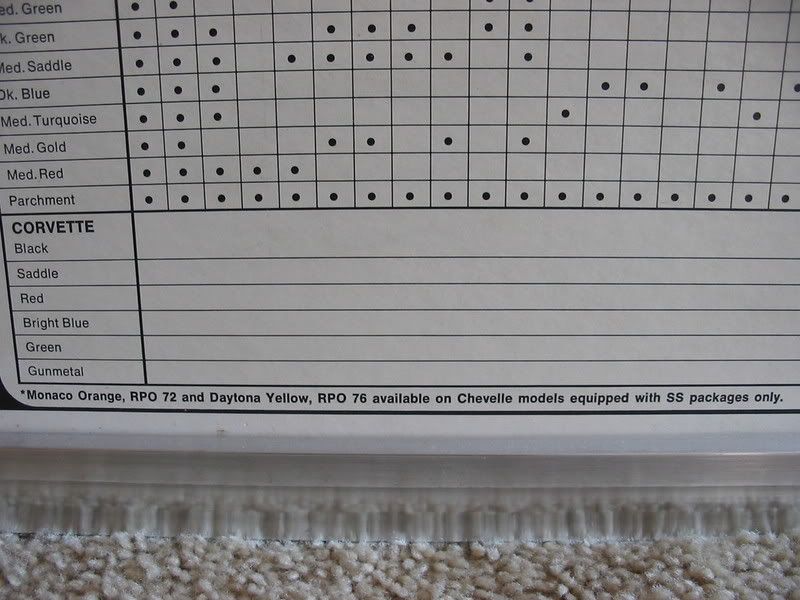

Everyone has very good points here and nothing was set in stone,but among other things,this would be the first Monaco/Hugger Orange colored 427 COPO Chevelle,(not to mention a Kansas-Leeds assembly),that most know of that has 72 72 on it's cowl tag.
Others 427 COPO's,(Baltimore assembly),have - - as were considered/assembled as a Malibu.
All Monaco/Hugger Orange 69 Chevelle Super Sports I've seen have 72 72,as dictated by Chevrolet.
Can anyone lead this topic to a <u>documented</u> 1969 Monaco/Hugger Orange Chevelle Super Sport with - - on its cowl tag,or a 427 COPO w/72 72 on it's cowl tag?

I could have sworn there was an orange COPO at an SCR with a 72-72 trim tag, but I may be (and probably am) mistaken. So I guess the only 72-72 COPO Chevelle I know of is this one right here...but I still think that's what it is.
Its quite possible (and IMO, likely) that this particular car doesn't follow the "accepted" norm for trim tag coding due to the low number of COPO cars produced at this plant, in this color. Lots of production/assembly line parts and assemblies for a COPO would parallel what was used for an SS, trim, hood, required options, etc. So it's quite possible the tag was done the same way an SS would be done if whoever was doing it wasn't familiar with the "norm" for coding a COPO car. That's of course if this turns out to indeed be a COPO!
