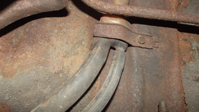

Originally Posted by SS427 View Post
Since last posting we have worked virtually every night and all
The fuel vent tubes were original so I simply cleaned them up and restored the original square tipped clamps. I found remnants of the old filter material in side the vent lines so using a heated bullet casing I hot cut new vent filters from foam from a garden tractor. After closer examination of the hose line bracket it looked to have been original phosphated so I re-phosphated my original, restored the screw and the rest of the electrical and hardware.
I think the 1969 Chevelles used a plastic fuel tank vent valve
they sell it has fitting 1968 to 1970 but some say it is 69 only?
I know they used to be hard to find so people would replace them with a home made unit.
it used to be hard to find but they repop it now

Thanks for the input Joe. A ton of research has been done on this fuel surge plastic piece since I originally tore the car down. You are right that many of the 69 Chevelles used this piece but not all. This was determined by not only looking at some unrestored survivors but also really looking hard at our car as it was disassembled.
For starters, there are two different bracket designs. One for the 2 fuel vent line mounting and one for the plastic vent mounting (see photos). My bracket that is on my car will NOT fit over the plastic vent. If you mount my bracket on a car with the vent, the vent will simply try and flop over. Also, the ones with the vent had a foam material in the vent opening while mine had the same material within the hose itself. I have confirmed this with a couple of survivor COPO owners so I have no doubt this to be correct. I am a firm believer in "never say never" and believe that mine is the correct way for our car.
Rick Nelson
