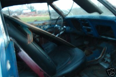

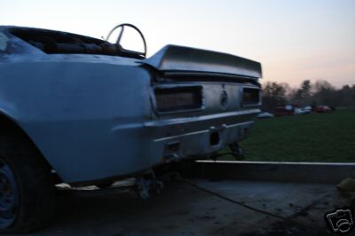

Default Pictures from 2008 Ebay ad Camaro VIN 124377N178453
Here are pictures of the body I received in 2008, showing the RS taillights, standard interior, cowl tag, and RS front clip. These are from the Ebay ad.

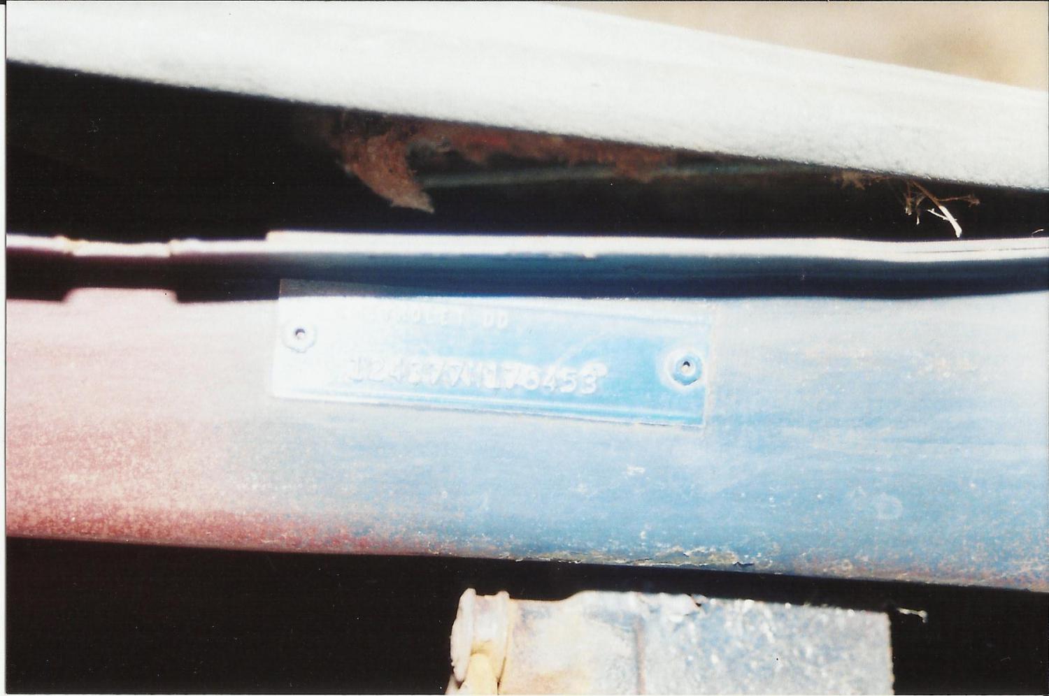

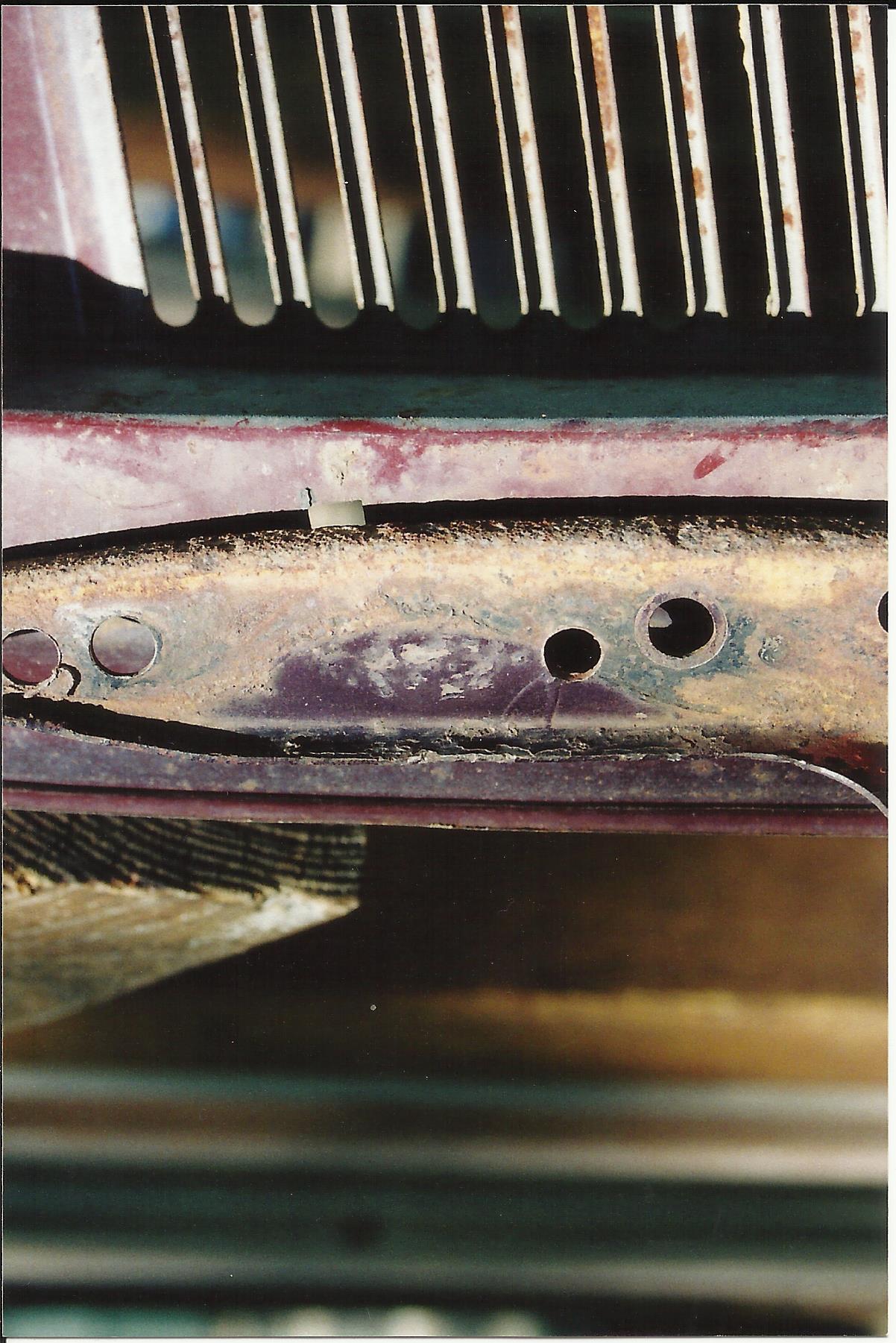

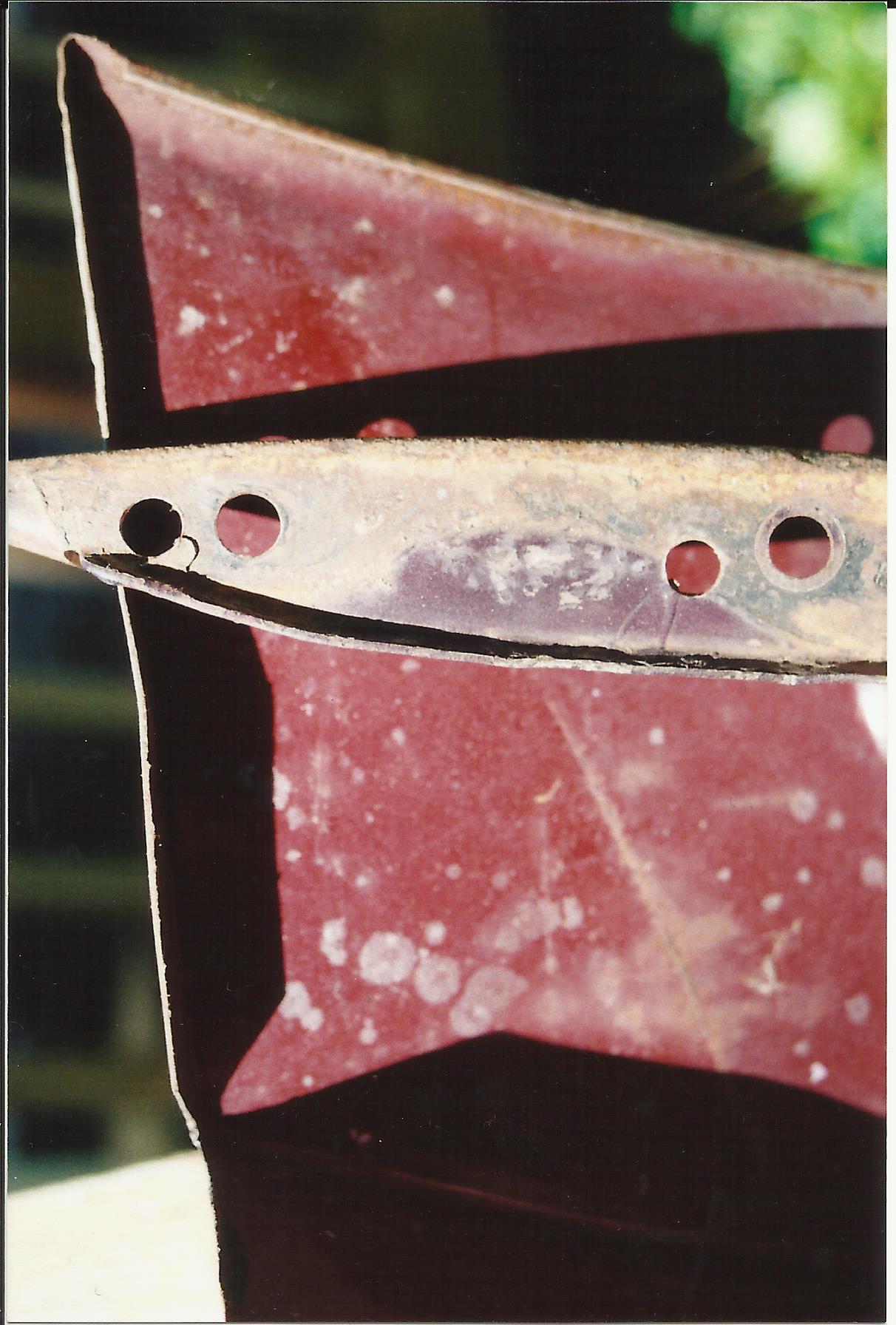

Default Inspection Pictures Camaro 124377N178453
These are my personal pictures of the VIN tag, cowl tag and underside windshield cowl panel showing what I believe to be original paint. Note the original Royal Plum of the fender reinforcement from Little Hoss, compared to what I believe is Madeira Maroon on the panel, which appears original. Note the rubber seal on the panel, I believe it is original to the panel, and never removed. Also note the upper cowl panel color in the cowl tag picture.
