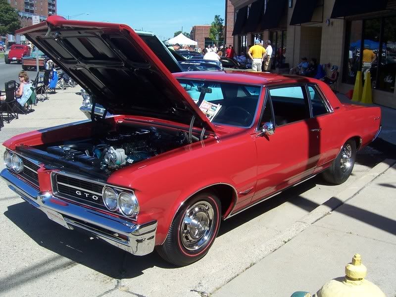

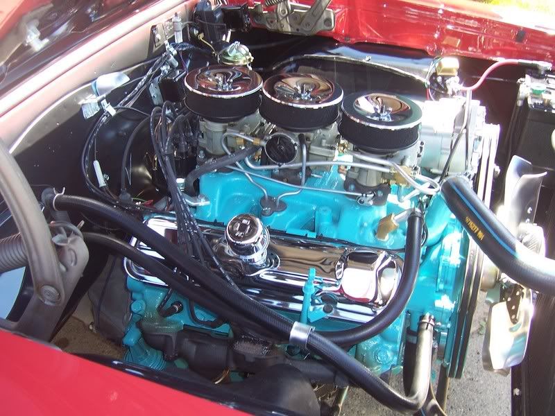

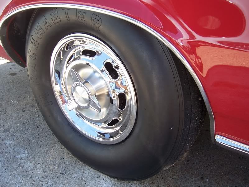

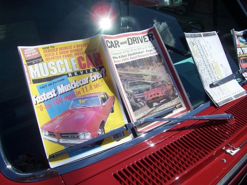

More Photos of Tenny's Awesome ride
Carl

Magnificent! What a beauty - what a piece of history.

Today the ’64 has a new driver’s side quarter panel, a new floor pan piece near the driver’s foot well and a new windshield. It has two new front fender wells - as the originals were cut away to accommodate the headers - and a correctly dated 421 HO block. The heads and intake pre-date the build by a few months, may be the originals, and so were retained – plus Milt had done some nice work on those heads! It has an M-21 as installed by engineering, and the original 10-bolt is back in its place. 3.91’s would be engineering-correct, though retained the 4.33’s that were in there as they’re ’64 dated, I’ve a Royal service receipt for their install – and they’re pretty fun. Aside from these items and the new carpet and headliner, it’s all the old stuff - meticulously restored. Scott even cleans and/or re-plates the hardware!

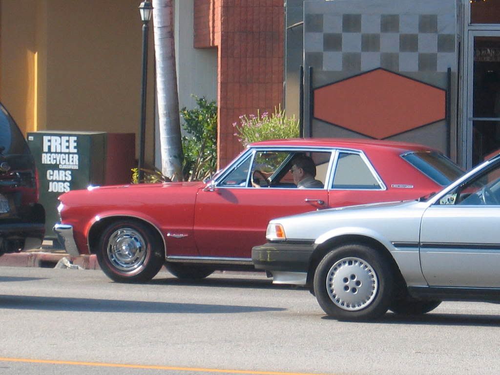

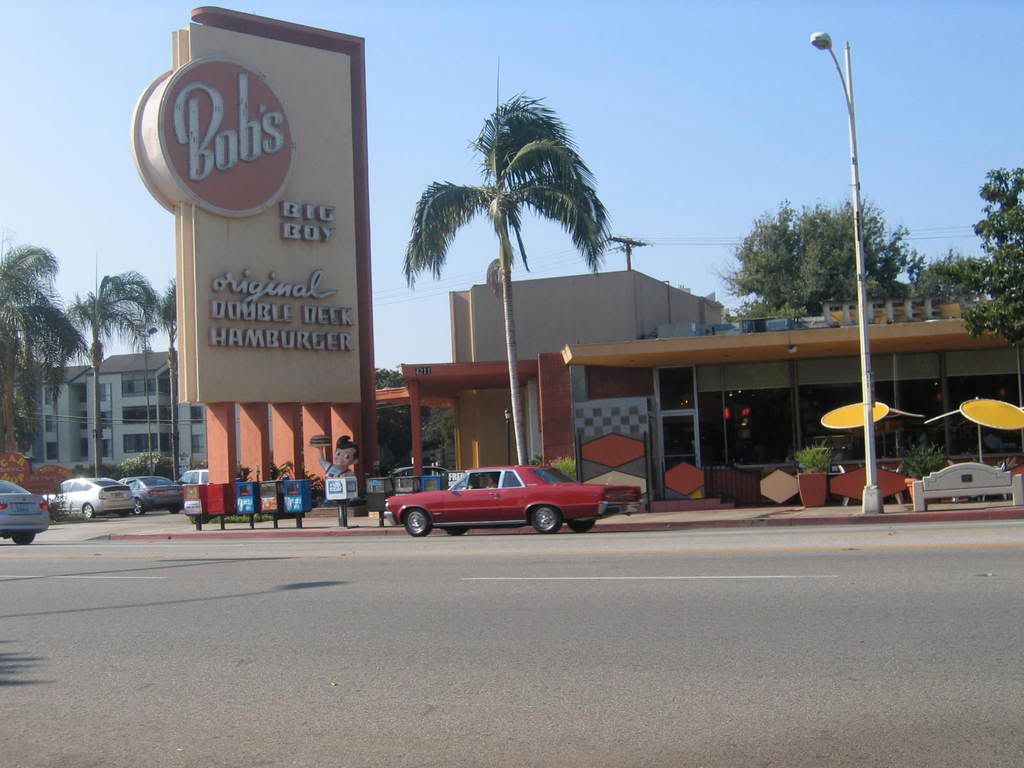

Default Wangers Pilots Tennys GTO
Wangers at the wheel in Tenney's awesome 64
Carl

The 250 Goat was a no-show in Florida, Sam, so Car and Driver said they referred to #'s from a previous test.
