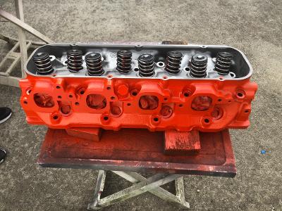

I want to provide an update for the first week in March.
Today, I picked up the engine from the machine shop and everything was in great shape. The engine was honed, boiled, cam bearing installed and freeze out plugs replaced. The crank, rods and pistons were are cleaned and checked against factory specifications. All clearances and specs were perfect with the block. The heads were machined to align to factory specifications with new springs, retainers and clips.
Over the next 2 weeks, the engine will be assembled to meet the Motion build requirements. It will be the same as what was delivered to (Bob) the original car owner in December 1971. I’m very excited to put this car back on the road to its former state as it was the only 1972 Chevelle built by Motion. More to come on this project over the next several weeks.

Default 1972 Motion Chevelle - Engine Update
The engine for the car will now be assembled as required. The engine was painted and all screw holes were cleaned up with proper taps to ensure good threads. In the next two weeks, I expect the engine to be completed and then I will move onto transmissions (M22 & Hone O Drive) for placement as well as fitting the Kustom Headers and Side Pipes.
My mechanic (Tom) and I have our work cutout to put this car back together. We all know if is easy to take apart but a real challenge to put back together keeping the original parts supporting the history.
I have provided some pictures and I will continue providing feedback until the car is back on the road and the original story posted in November 2009 will come to a close.
