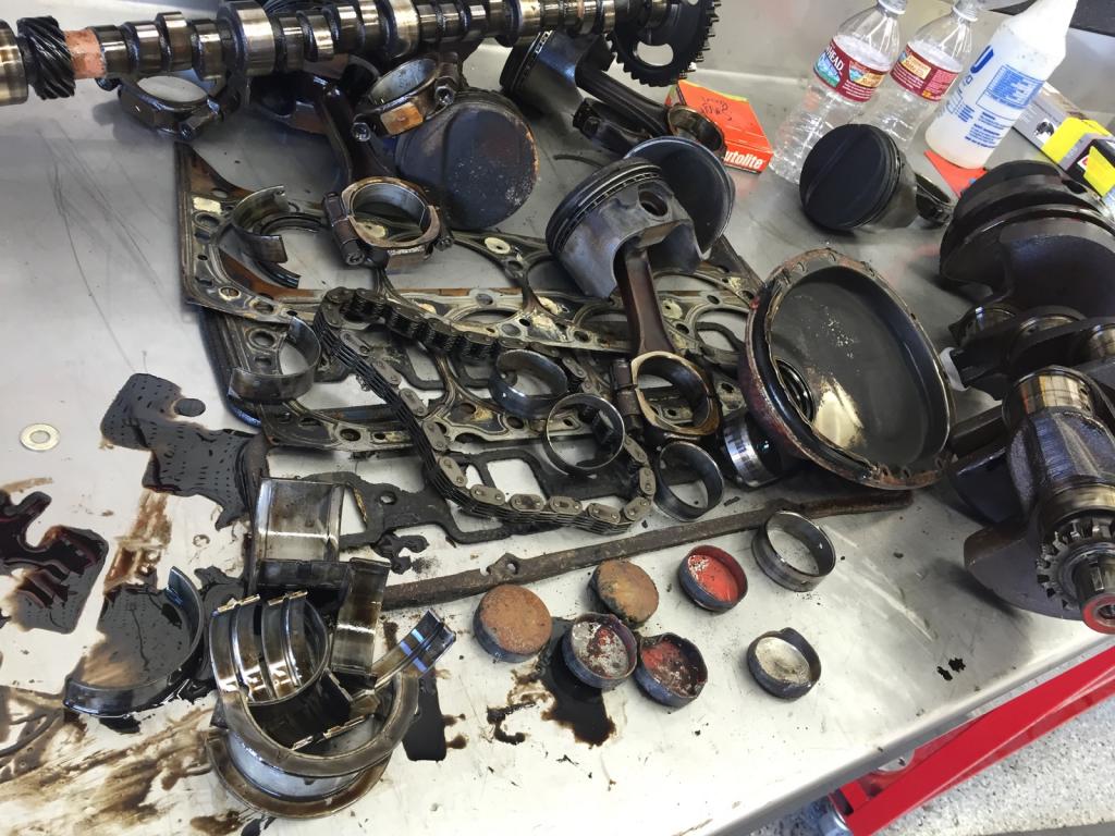

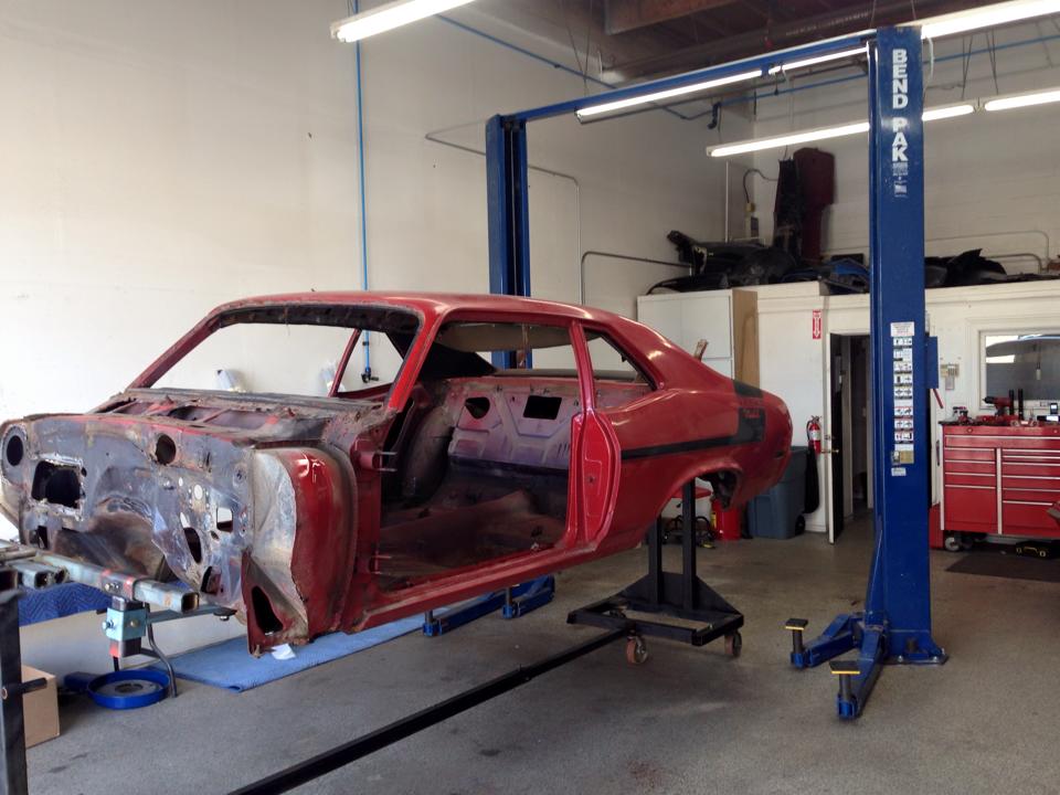

Some more pics, engine torn down, shell on rotisserie and ready for media blast : )
[img]https://www.yenko.net/ubbthreads/pics/use...62022717848_707[/img]
[img]https://www.yenko.net/ubbthreads/pics/use...62022077832_278[/img]

It will be interesting to see what method is used to repair the rust (that is -- if there is any damage) on the top and side of the windshield opening ...

<div class="ubbcode-block"><div class="ubbcode-header">Originally Posted By: earntaz</div><div class="ubbcode-body">It will be interesting to see what method is used to repair the rust (that is -- if there is any damage) on the top and side of the windshield opening ... </div></div>
On any areas of rust, we will be using the original panels and metal finishing in small sections as needed. Its always at least twice the work but well worth it to keep the sheet metal original.

I trust you are taking plenty of photographs of codes and markings? That is such an important part of the tear down process, and we've learned a lot from the Deuces that have documented restorations. Specifically, inspect the firewall for grease pencil markings, front suspension components for paint daubs, subframe for date stencils and inspection stripes, driveshaft for application paint rings, rear diff for inspection scribbles and paint daubs, and the sides of the engine block / ends of the cylinder heads for crayon writing. A little time spent documenting will pay off huge in the finished product! [img]<<GRAEMLIN_URL>>/biggthumpup.gif[/img]

So far we have taken more than 200 pictures [img]<<GRAEMLIN_URL>>/smile.gif[/img] we are sharing all with Ken S and I will send you a Zip drive with all the photo's for your files [img]<<GRAEMLIN_URL>>/smile.gif[/img] as far as rust, very little in window area, etc, what you are seeing is mostly surface and dirt. We will post some pictures after media blast [img]<<GRAEMLIN_URL>>/smile.gif[/img]

That is awesome! Can't wait to see them - this is how we learn about these cars, so good job taking the pics.
Check the sides of the engine block, many times the engin code (CTC in your case) will be written on both sides, in yellow crayon, upside down. Also, you might find white &quot;X&quot;'s on the ends of the heads, under the Orange paint.
