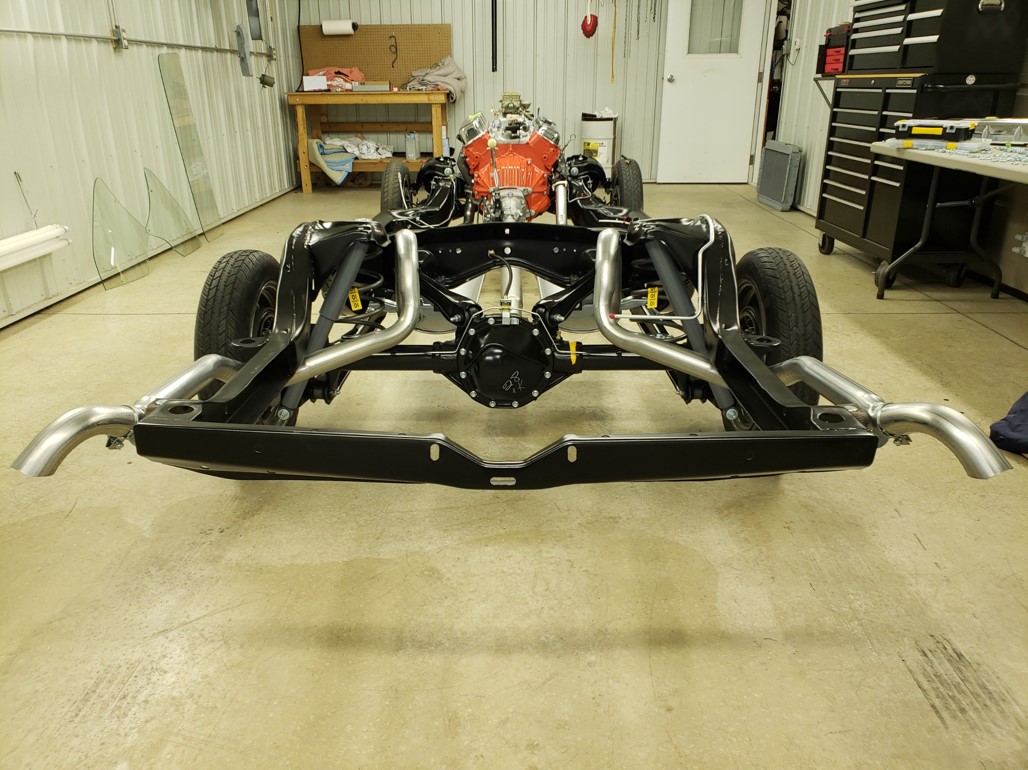

Default Gardner Exhaust
I opted for a Gardner Exhaust. Very happy with fitment and ease of install.

Default Fuel Line Setup
I was gonna throw out there that I can offer a correct functional fuel pump, elbow and line setup if anyone is interested. I had to take the fuel pump and properly machine it to accept the 90 deg brass elbow. I made a custom line from several original 66l78 pictures I had been given. I then had a company cnc bend my template. Turned out very nice. Please PM if your interested in a setup, or just the line.

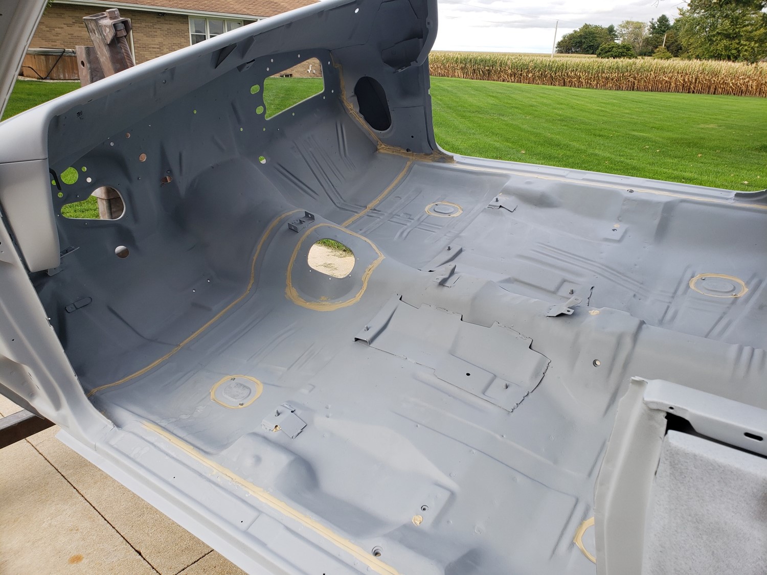

Default The end of Metal Work
It looks pretty ugly, but all rot has been removed and all panels replaced with used GM metal, next step is to acid the body panels and sand blast the rest. Sadly I thought I was done, but as you will see in a few pictured down the line I tried shrinking some dents on the roof with some heat and that just turned into a massive oil canning mess

Default Body Work Complete
These pictures represent a few hundred hours of block sanding and just sanding in general. Panels have been guide coated. Body seams have been seam sealed. Time for edging and chassis black paint now.
