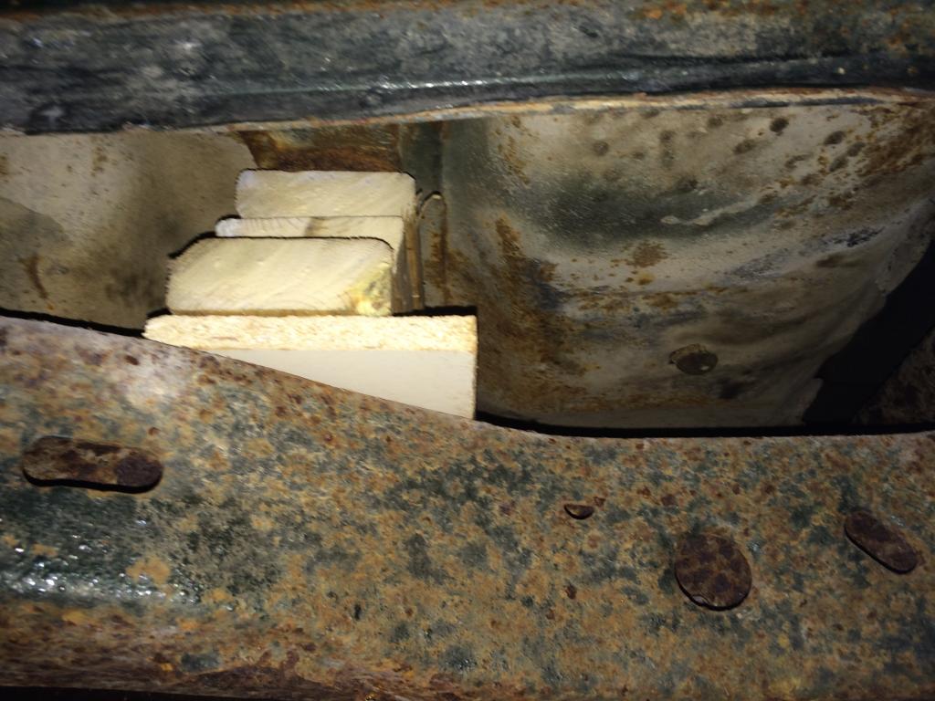

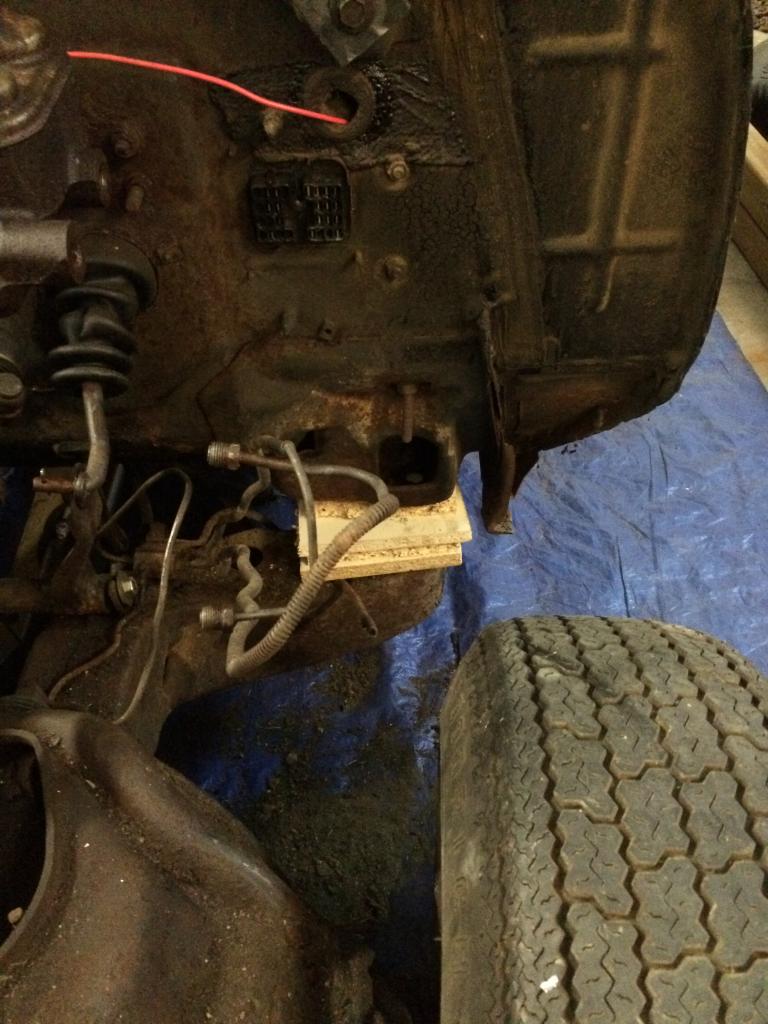

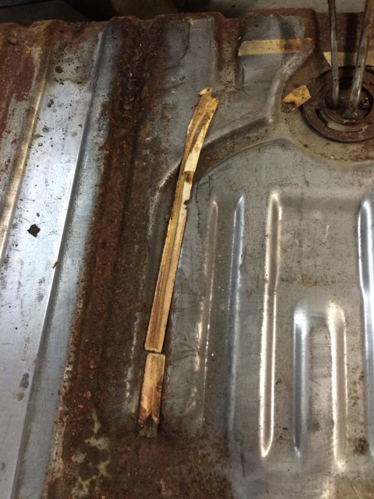

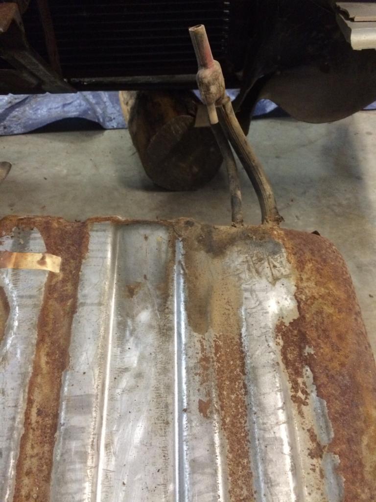

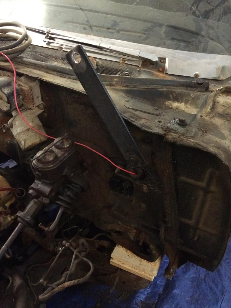

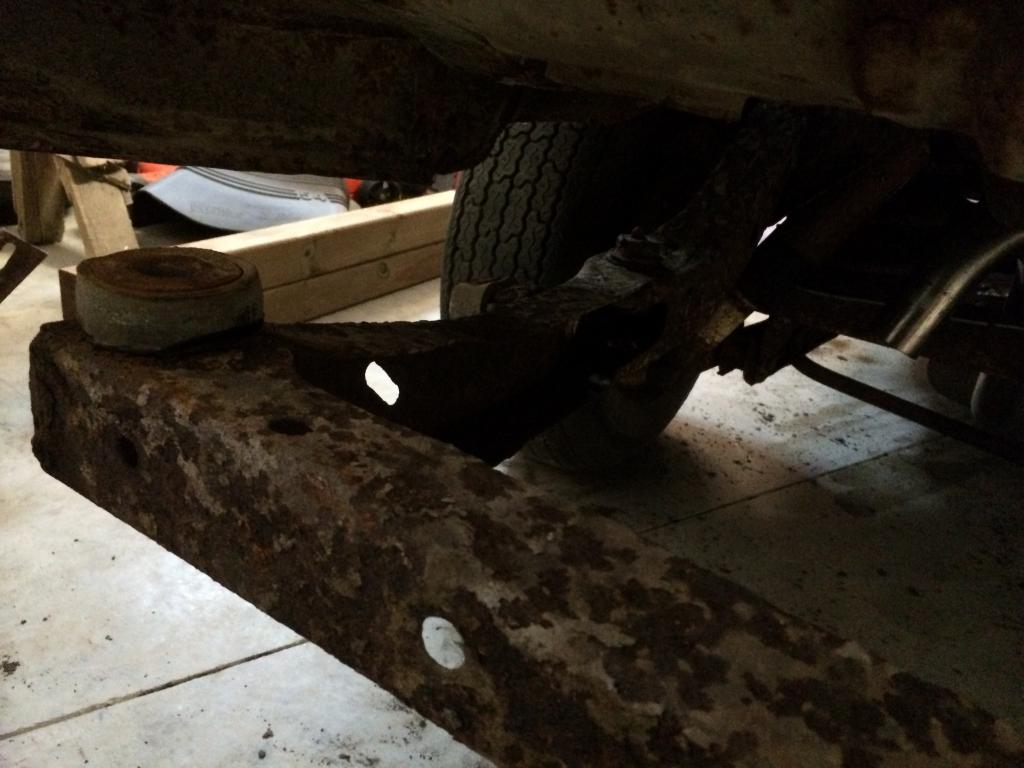

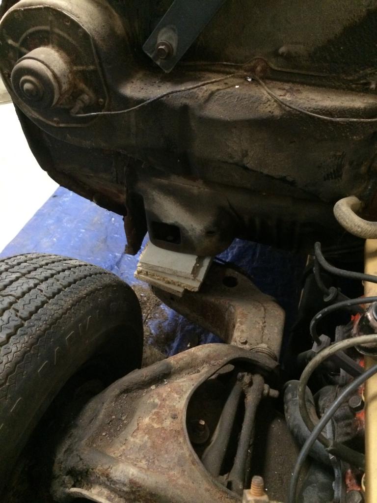

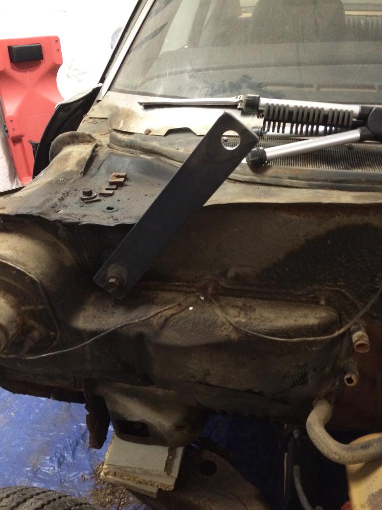

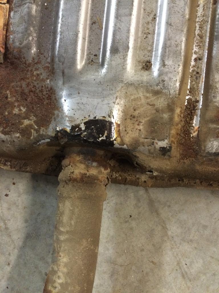

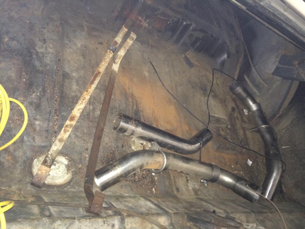

Getting prepared for Sat:-)

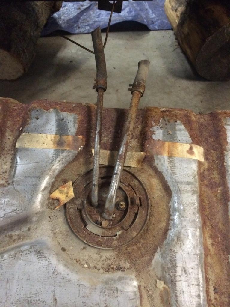

Stopped by last night to test fit a few lifting brackets to simplify the rigging. Need to pack up two engine hoists, shackles, straps, etc.
A few of the pictures show the wood blocking between the frame and the body, a few gas tank pictures, and a few showing the floor pan and frame.
Ryan

Removing all the interior, glass and doors would make your task a lot easier. The lighter the body the better. That way you can lift it by the trunk latch brace in the rear and by the top two fender bolt holes on the top of the cowl. That way requires two cherry pickers. You also can use the seat belt bolt holes from the interior, which only requires one cherry picker. Either way, you need to have the body as light as possible.

I removed my convertible body years ago by pulling the rear up first, using the seat belt anchors. Then lifting the front using the front body mounts. Only one cherry picker needed.
