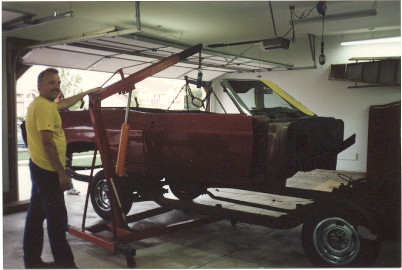

You may be upset now, but in years to come, you will just consider it a part of the learning process.
Here was my body-off moment 24 years ago....If I did it, so can you!!!
Bill Pritchard

Bill,
I Remember this picture....Priceless [img]<<GRAEMLIN_URL>>/biggthumpup.gif[/img]

Thanks for the vote of confidence!!!
Ryan

<div class="ubbcode-block"><div class="ubbcode-header">Originally Posted By: Canuck</div><div class="ubbcode-body">I removed my convertible body years ago by pulling the rear up first, using the seat belt anchors. Then lifting the front using the front body mounts. Only one cherry picker needed. </div></div> X2. I have used 4 chains (or 2 long ones) In a criss cross pattern attatched to the rear seat belt mounts and there are two holes suitable for lifting by the kick panel area. put the engine hoist in the middle and lift. the car will be a tad back heavy but with a buddy or two they can lift and guide the chassis out of the way. I'd hate to see the body sway on you and make those firewall brackets distort anything.

I have two engines hoists ready to go, and we have cinder blocks and 10 foot long 4X4's for front and back, so we will add blocking (1.5 inch thick wood) as she goes up till an additional block can be added, no swaying, no risky stuff:-)
Very excited, and nervous!
Ryan
