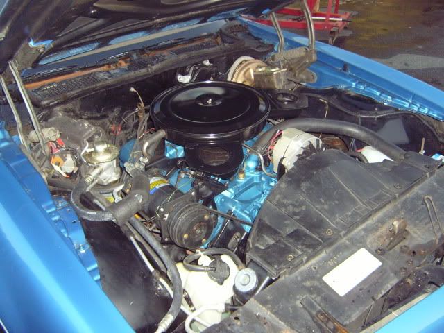

Default Re: Gramma's Car: the new project!
Had to wait for the wife and daughter to get home this evening to put the hood back on. Then I washed all the dust off and fixed a broken A/C compressor wire. Now everything works at the moment but the high speed on the blower fan, which didn't work before the rebuild, anyway. I think the relay has gone bad.
Here's some shots after the bath.
